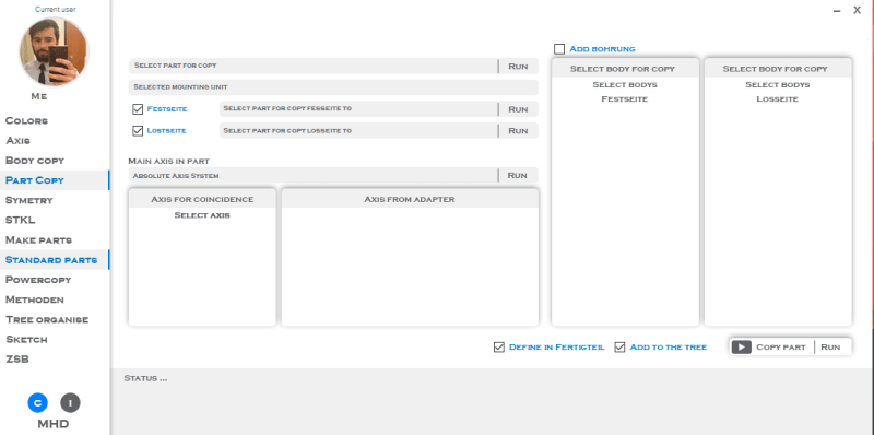

Hello
I prefer the option with the axis, but it depends on your models.
Maybe sometimes this option is not the best.
For this purpose, I made two different macros. One macro is for creating axis system from sketch points, with rotation and translation
and another one is to put parts on those axes in assembly. Here are the pictures.
Visit my webiste for more cool stuff [link catiavbmacro.com]catiavbmaco.com[/url]

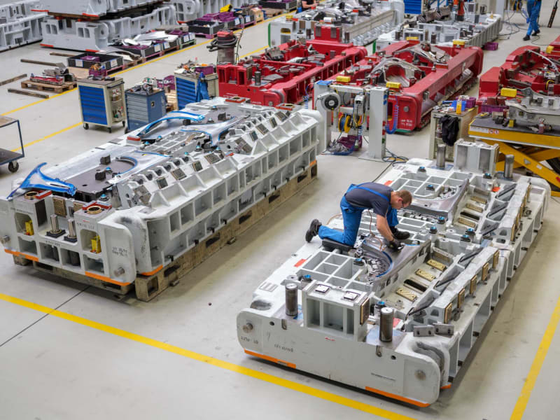

Why do you need an exploded view? I never use it, so I don't know that.
Also, I don't know what is a problem with manufacturing?? I construct a tool dies for auto-industry.
Visit my website for more cool stuff [link catiavbmaco.com]catiavbmaco.com[/url]
Nice tooling. The reason is MRBs. Bushings installed from the wrong side. Rivets Mfg. head on the wrong side. The reason is a shop floor. Where I work we are a M&P Engineers, so I have to deal with all the shop floor mistakes.
