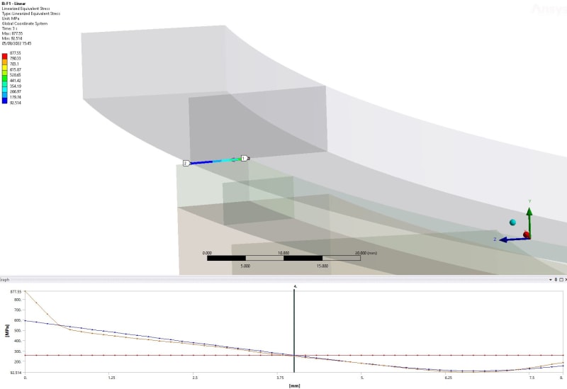

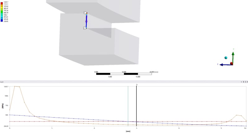

I have excluded peak component with a classification path in the direction of the principal component S1 (>>S2) since cross section path classification is not well defined. M+B is around 500 MPa > Sps = 345 MPa.

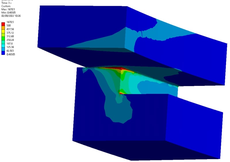

Elastic linear analysis
Stress ranges and linearization path. Sub-model with rounded corners of R0,25 to minimize singularities stresses:

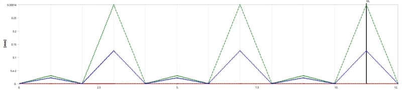

Plastic strain values of the main cycle:

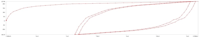

Hysteresis loop of Signed Von Mises Stress vs total strain of the main cycle on the worst node:
I would say that elastic method is not valid. I am currently performing elasto-plastic (5.5.4) and assessing the worst point with ΔSp.k=384 MPa, Δεpeq.k=0,011, Δεeff.k=0,013, Salt.k=1260 MPa and S-240 316L, which lead to Nº=250-500 cycles when our target is 6000 cycles.

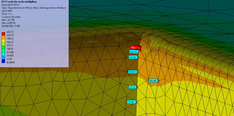

Fatigue assessment node:
The linearization line should be perpendicular to the principal stress, but now seeing your results it appears likely to be outside the elastic range. Have you also performed the EP ratcheting assessment?
The twice yield method can be applied with the load range applied in a single step. If it is non-monotonic, you will need to apply each range separately, starting from the initial condition at points of inflection. However, if you are relying on plastic shake down then the cycle by cycle method is probably the way to go.
The EP methods may not be sufficient, the part may still need to be redesigned or a higher strength material used.

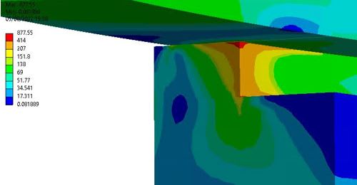

These stress contours confuse me. Can you please re-plot the stresses, but with the following contour intervals:
0.5*S
1.0*S
1.1*S
SPL
SPS
A Large number
And where exactly is your SCL? I see some high peak stresses, but nothing that would indicate that you have some description of cyclic plasticity that would require you to go to a EP Fatigue analysis. What is the driving force behind your peak stresses? Is it geometry only or it is thermally-driven?

You are right. With a correct linearization path Membrane+Bending range = ΔSn.k = 600

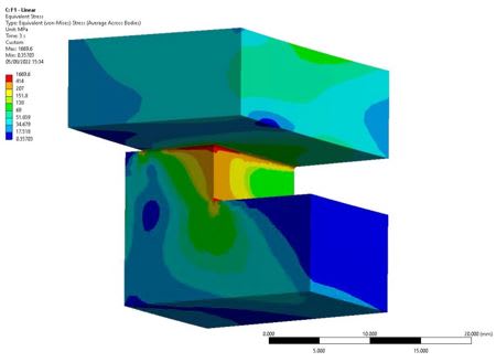

Von Mises stress from elastic analysis under max pressure value of the load cycle.
Same but with a submodel with rounded corners:
Peak stresses appear due to geometry. EP ratcheting is passed. Proceeding with 5.5.3.2 Step 4 (Ke) for ke>1 needs to accomplish the criteria of 5.5.6.2 which is not meet since ΔSn.k (without thermal stress)= 600 MPa > Sps. Am I wrong?

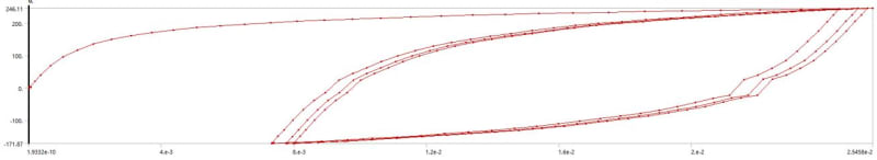

Signed equivalent von mises vs sum of principal total strain of the most severe node from EP analysis with multilinear kinematic hardening material: (Stress & strain ranges from the last cycle are similar to those from stabilized hysteresis loop which will be reached according to EP ratcheting verification):
Should I cyclically apply the amplitude of my loading cycle with material properties from 3-D.4?
