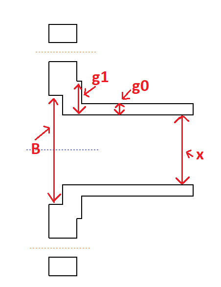

I want to make sure my assumptions are correct, is it wrong what I have considered for my inside diameter for the flange value "B", and for the hub thickness "g0" and " g1"?.

What flange standard are you using or hoping to use? [This is custom flange I'm making, using ASME SECTION viii appendix 2 to design the flange.]
These would all give you the relevant dimensions, including the holes information for fasteners etc. [ If I use a standard like B16.5 then yes, all dimensions of the flange are provided. Unfortunately, I can't use the standard flange design]
You need to consider if the flange is made integral with a component, a loose slip on flange retained by a lap joint, welded o etc., plus the material grade and corresponding rating developed from the pressure and temperatures. [ Integral flange, cast carbon steel (WCB) , the pressure and temperature rating will be per

SnTMan, I do have copy of the Apx 2.
The confusion for me is that Apx 2 shows in all integral flange figure that "g1" and "g0" is taken from the reference point of variable "B" but B is defined as the inside diameter of the flange and "g1 & g0" is defined as the thickness of the hub. I could not find text passage that showed when you have two inside diameters in the flange envelope, which should be considered for each variable. If you know the passage that will clear up this confusion it will be most appreciated.
As my figure has shown, my plan was to take the biggest inside diameter for variable B and have g1 and g0 taken from the small diameter. This best matched the description of each variable provided in the document.
Tomthumb67, your flange designs do not neatly fit within Apx 2. You will not find language on how to treat two ID's, OD's, bolt circles, etc. There are ways to make calculations for your proposed designs by disregarding some portions of the flange, or alternately treating some missing portions as "being there", if sufficiently small. No definition offered.
The former case is used when a flange facing is present, see Fig 2-4, Note 4. Note facings may be male or female. The latter case may sometimes be used when a flange is designed as a packing box, using a braided packing rather than a gasket.
If I were to attempt to design the flanges you have shown I'd likely use one of two alternatives as shown on my markups of your sketches. I'd need an overwhelming incentive to do so. I much prefer to prepare designs for which I can easily perform calculations, rather than trying to fit calculations to a design for which they were not intended.

SnTman, Thank you so much. That makes it much sense.
Bit of a fudge :) Best of luck.
