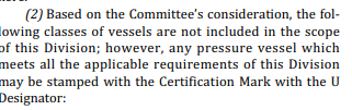

Interesting excerpts from Sec VIII-Div-2 Cl.U1-Scope (2)
Since your vessel is a filter, it may not fall under Div-2 scope.
Now it is up to you to decide whether to use SB443 material or not. Of course applicability of other ANSI/ASME piping codes needs to be checked.

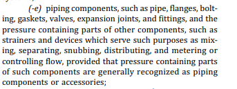

That looks like the paragrapgh of an old code. The new wording is below.
VIII Div 2 1.2.4.2 said:
(d) Structures consisting of piping components, such as pipe, flanges, bolting, gaskets, valves, expansion joints, and fittings whose primary function is the transport of fluids from one location to another within a system of which it is an integral part, that is, piping systems, including the piping system between a pressure relief device and the vessel it protects, see Part 9.
(e) Pressure-containing parts of components, such as strainers and devices that serve such purposes as mixing, separating, snubbing, distributing, and metering or controlling flow, provided that pressure-containing parts of such components are generally recognized as piping components or accessories.
The vessel itself is within the scope of Div 2 (according to the OP). The filter cartirdge is covered by the clause above, however the tubesheet isn't. It is either an attachment or a pressure part.
