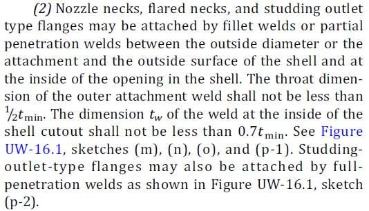

According to Sect VIII-1, Ed 2019 clause UW-16(d)(2) as per attached photo,
the studding outlet may be attached as per Fig UW-16.1(p-1) OR figure UW-16.1(p-2).
Can we use UW-16.1(i) or UW-16.1(k) for partial penetration?
MdRizal, if I understand correctly you propose to insert the studding outlet through the vessel wall, rather than set on the vessel wall.
The former case is governed by UW-16(d)(1), the latter by UW-16(d)(2).
So, yes, design per any of the applicable sketches and associated requirements is permitted.
I am reading from the 2017 Ed, you would need to confirm per 2019 Ed.
Regards,
Mike
Thanks Mike.
This issue have been raised by A.I, they reject our design due to selecting welding figure for studding flange which is not stated in the Code.
A.I said that Studding Flange not similar with Nozzle Neck. Studding Pad not need UG-45
The only clause to comply is UW-16(d)(2). That means only 2 figure is acceptable, here are UW-16.1(p-1) & UW-16.1(p-2) in 2019 ED.
MdRizal, although I don't have access to 2019 Ed, I can't really buy into your AIs' argument, and I don't see the relevance of UG-45 to the weld detail.
However: He (or she) is your AI, and you must satisfy him (or her).
