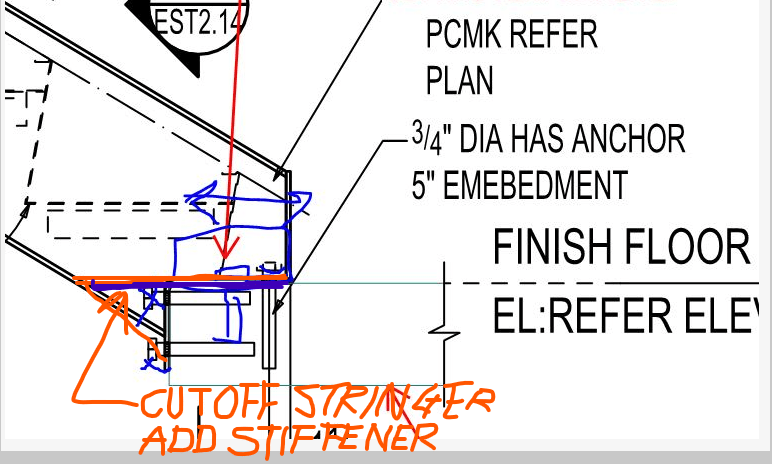

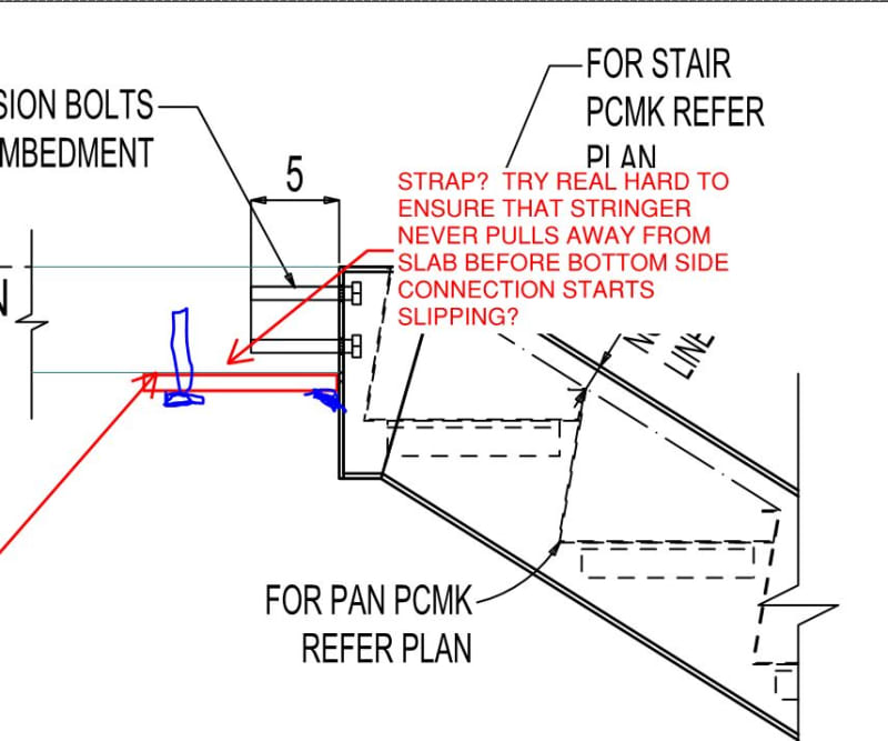

I have a project where I was engaged to provide calculations for a set of steel stairs that a fabricator had designed. Being in California, it is important that these stairs satisfy Section 13.5.10 of ASCE 7-16 with connections that can accommodate drift. Unfortunately, these stairs were hard connected into both concrete landings at the top and bottom of the stringers with no slip provisions. Even more unfortunately, these stairs were built long before we were engaged. So, we now have to figure out how to make sure that the stairs are supported should one of their connections, top or bottom, become detached when the floor diaphragms move separately from each other during a seismic event. The concrete landings are thing (6-7.5 inches) and give very little room for an easy anchorage detail, especially when the omega factor is applied. So, has anybody out there dealt with a similar situation? If so, what type of sliding connections have you used to work around the already-constructed stairs. It's quickly getting complicated and I just want to see what other people out there are doing in similar situations. The ASCE provision is new to this edition and I feel like not many people have been taking this into account in their past designs. So, let's chat and see what comes of it. Thanks for your input everybody.

All- I attached details of both the top and bottom connections for further info. This is for a stringer between the 2nd and 3rd floors so neither connection has room to just slide around should their connection fail.

Some conversation starters. I agree with HTURKAK's concern for stair participation in global lateral resistance but perhaps that's the EOR's problem in this situation.

At the low connection, could you pull the nuts off of the two horizontal anchors and cut the base plate away at the one vertical anchor to facilitate some travel?

i= knowing top connection is weaker than bottom, the disconnection and detach will be at the top.. providing a bracket with spigot connected to the slotted hole of end plate will prevent the falling down .
ii= Take out the horizontal and vertical anchors ( expansion bolt ?..) at bottom connection... drill new slotted hole 2 in. length at bottom plate of stringer and one vertical anchor.
iii= Take out the expansion bolts at top connection , and drill new hole 2 in. diameter with length 12 in. at landing slab. install 1.5 in pipe with epoxy. and use 1.25 in. threaded rod for connection to end plate. ( the rod is axially free to move in socket pipe )..
