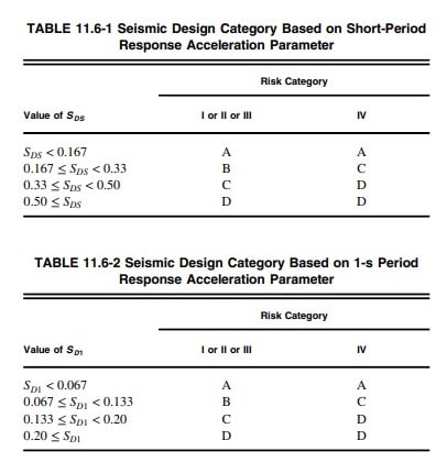

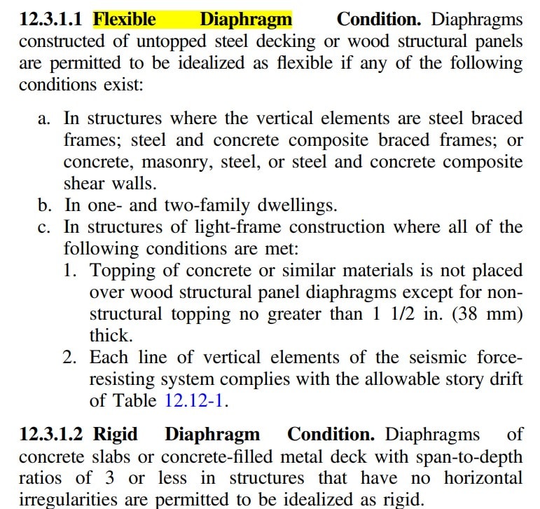

Section 11.6 allows us to use only table 11.6-1 to determine the SDC, which in my case lets me go to SDC C from D, which is pretty desirable. It points to 12.3 for the rigid diaphragm conditions, which seems to be only allow concrete deck to be called rigid. I'm wondering if there is any way justify calculating the actual stiffness of my diaphragm in order to call it rigid - I've come up empty handed so far.
What does your diaphragm consist of? Can you make an argument of a semi-rigid approach acting sufficiently stiff to provide justification for your intended situation? What does the commentary say?
If we are talking an untopped steel diaphragm they are pretty flexible and code permits them to be (blindly?) analyzed as flexible, if your moment or braced frame spacing is small enough, the diaphragm might calculate out as rigid.
Side note - the diaphragm deflection checks for rigid (by calculation) are performed at strength level forces, as I recall. If that helps or doesn't help, I don't know offhand. I think you need to either a) design quite a bit and iterate to "force" the systems (walls, frames, diaphragm) to satisfy rigid diaphragm analytically, or b) go with SDC D.
It's a braced diaphragm - I'm wondering how I can prove it will be rigid to satisfy the requirements of 12.3. It will be stiff enough to behave like one in this application, I just need to weasel out of SDC D (well I already have an out, which is to make the roof concrete, but I prefer not to do that).

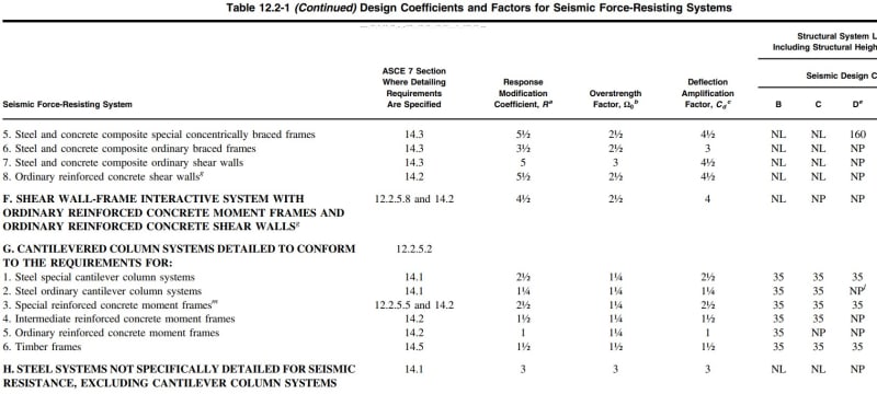

R=3 for regular steel is not permitting for SDC D, and OCBF is only allowed for 45' tall warehouse buildings (I think a stretch to even use that in my case if I was even short enough). So I'm into an expensive system and want to squeeze into SDC C. There are some requirements that can be used to show you are flexible, because normally you want that, but if you don't meet those you are into semi rigid. I need something to lean on other than just my deflected shape, if such a requirement exists.

SDC is seismic design category, it varies based primarily on the Risk Category of the building and the two/three seismic acceleration parameters, SD1 and SDS and perhaps the long period one I forget the nomenclature for, TL.
When you have a lower SDC, (A, B, C), you have to option (in steel) of not detailing for seismic resistance, so you use an R=3, the other options use more detailing and reinforcing of the various elements and allow the use of larger R values.
R value is a divisor in determining the required resistances so the higher R value produces lower forces overall, but there are areas where the steel structure must be appropriately reinforced to preserve ductility under the required seismic forces, which can increase cost, sometimes more than if you designed for larger forces and R=3 and omitted the seismic ductility reinforcements of the various sections. For higher seismic design categories the R=3 option isn't allowed. (the table below shows H. as "NP" for Seismic Design Category D, "not permitted."

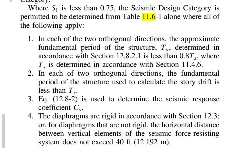

Normally design is required to be done for the more severe of the two seismic design categories determined from Table 11.6-1 (short period) and Table 11.6-2 ( 1 second period).
OP wants to wiggle into SDC C to avoid the detailing requirements, or I guess to permit R=3, which is possible in concept, provided all the correct seismic parameters cooperate.
Source: ASCE 7-16
If you can't satisfy the requirements for the exception, then you need to design for Seismic Design Category D and provide the necessary detailing and reinforcement to the steel system.

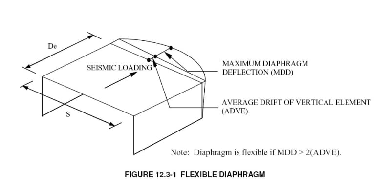

Thematically, I suppose this is correct, or close enough, or it doesn't much matter "why", but I'll delve into the semantics a bit, if you're in the mood.
The check is to establish that the diaphragm is stiff enough to be reasonably accurate to model it as rigid, meaning that the stiffness of the diaphragm doesn't strongly influence the distribution of the lateral forces into the vertical seismic load resisting system ("moment or braced frames/shear walls") - so when you have a relatively stiff vertical system (braced frames, shear walls), that will help produce rigid diaphragm behaviour because the deflection of the vertical elements is lower than a moment frame.
EDIT - This isn't well worded. The check in question is to establish if a flexible diaphragm analysis is permitted.
It's the stiffness of the diaphragm relative to the vertical systems, so a stiffer (wall/braced frame) system means the diaphragm must be comparably stiff, a more flexible (wall/moment frame) system means the diaphragm must, again, be comparably stiff. The check is that the diaphragm deflects up to twice the average deflection of the (wall) system. If the diaphragm deflects "too much" (so to speak), relative to the vertical elements (wall), the diaphragm is permitted to be idealized as flexible. {meaning passing this check doesn't guarantee rigid diaphragm behaviour). This check doesn't prove rigid diaphragm behaviour is expected, it proves that flexible diaphragm analysis does or doesn't apply, so it's not quite the same thing, it's just something that's in the code, and if you don't satisfy it, you can't use a flexible diaphragm in the model.
If you do "fail" this check, it indicates that a flexible diaphragm condition doesn't really exist. As a side note, for this structure, we are presuming there are steel braced frames below, more or less, or rather, typically if there's a braced frame below the untopped steel deck, it would be permitted to analyze it as a flexible diaphragm per 12.3.1.1(a)
If the diaphragm is (strong enough) and stiff enough, the forces in the vertical elements will be distributed based on the relative rigidity of the vertical systems, so the one frame, if it is ten times stiffer than the other, it's going to take 10 times the lateral force, in a simplistic sense.

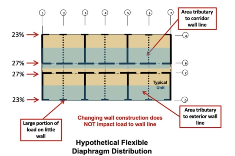

With a flexible diaphragm, the forces are distributed based on tributary length, so if there are three vertical systems, the one in the center takes more force, but not due to the stiffness of the diaphragm, it's due to the larger tributary width (half the load, say, versus 25% on the ends), provided the middle one is in the center of the building.
OP has a steel deck, conventionally this is considered a flexible diaphragm, "untopped steel decking".

There's two three ways to do this -
a) provide a concrete filled metal deck diaphragm. Which will be heavy and increase the lateral forces from seismic, perhaps influence the structure below due to added weight, including foundations.
b) add another frame so the 40' distance requirement is satisfied.

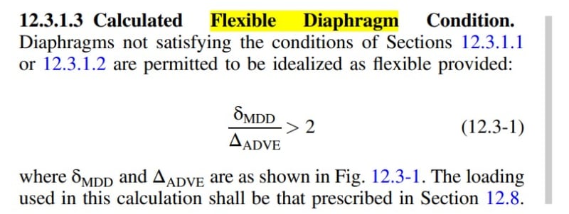

c) prove it does not satisfy calculated flexible diaphragm. (Maybe) I don't think the code really says "rigid diaphragm required" if you fail this check, but it stands to reason that the force distribution based on a rigid diaphragm (or semi-rigid, maybe) would be based on rational principles of mechanics and the alternative would be less accurate.
Classifying Wood-Sheathed Diaphragms as Flexible or Rigid, Woodworks, kind of backs up my reading of c) above. And it discusses the force distributions for flexible and rigid diaphragms in a reasonably clear fashion.

12.3.1 does say that you need to consider the diaphragm as semi rigid if it can't idealized as rigid or semi regid

The "calculated flexible diaphragm" is a way of showing that the diaphragm acts reasonably close to flexible. If you don't satisfy the check a more detailed analysis is needed, but it doesn't technically make it a rigid diaphragm, however. I mention it because I think you have to disprove flexible diaphragm via calculation as part of proving it's a rigid diaphragm. Plus, the calculation is pretty straightforward and well-established.
When you are between rigid diaphragm and flexible diaphragm behaviour that's where we get into "standard of care" and an analysis that must be based on generally accepted principles of mechanics.

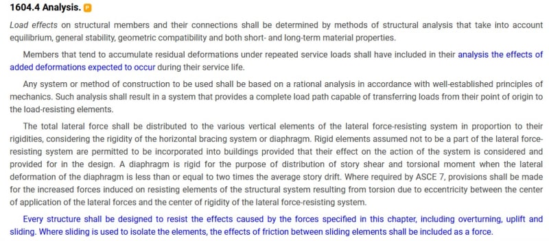

Any system or method of construction to be used shall be based on a rational analysis in accordance with
well-established principles of mechanics. Such analysis shall result in a system that
[u]provides a complete load path[/u] capable of transferring loads from their point of origin to the load-resisting elements.
(emphasis added)
Code:
The total lateral force shall be distributed to the various vertical elements
of the lateral force-resisting system in proportion to their rigidities,
considering the rigidity of the horizontal bracing system or diaphragm.

I don't agree, but if you satisfy conditions 1, 2, and 3 in Section 11.6, above, and ADD vertical elements of the seismic force resisting system at 40' spacing maximum, you can actually satisfy the code and do it for SDC C.
If I were to go your route, (if it even panned out, we are talking about an untopped steel deck diaphragm in a fairly high seismic zone) I'd contact the relevant building official (and get sign off from the future owner), and see what they thought of it. That way, you aren't producing what could be viewed by the building official as a defective final design that violates code. Code review in what I suspect is California can be particularly precise.

Imagine 3 walls connected with a flexible slab. Each wall gets force according to its tributary area. Now change the middle wall material to pudding instead of concrete. The slab is still flexible, but only the outer walls get the force. You see, in the first case slab deforms with 2 "waves". This wave is large enough (2 times larger than wall deformation) to make it flexible. In the second case, the middle wall is basically air so you get a slab with a deformation that looks like one "wave". Still, it can be flexible if deformation is large, but forces are wildly different.
I definitely agree that you'd need to be careful, especially in a high seismicity area, but I do not like the idea of talking about some system being rigid and the other one not, although it is usually very useful. Make an untopped steel deck extremely thick (or add strong diagonals, we use different flooring systems in Europe) and you have a rigid diaphragm... it's all about the stiffness relationship.
If the middle wall isn't viable as a load path, you'd consider the diaphragm to span the full width of the building and then the end walls each taks 50% of the load (there's some eccentricity with wind loads if you have end zone pressures).
