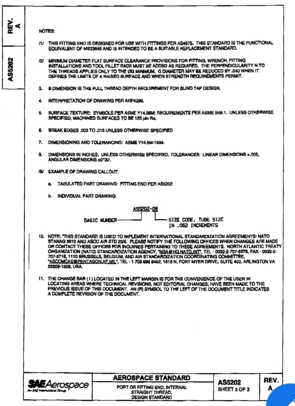

I need dimensions for AS5202 ORB Plug or male fitting but can't find them on the internet. I found the fitting end AS4395 in Parker O-Ring Handbook Table 4.4 but Parker says only the o-ring size applied to the AS5202 port and not the dimensions. The AS4395 male end fits the AS5202 ORB but the seal gland doesn't look right (see attached). Parker told me that AS5202 and SAE J1926 are not interchangeable, and therefore the plugs are not interchangeable so AS4395 will not fit AS5202 BOSS, just the J1926. I interpret the Parker Design Table 4.4 as saying the Fitting End is compatible with the J1926 and AS5202 Bosses. The threads are different but interchangeable in the case of a UNJF Female and UNF threads on the male end and AS5202 has a tighter 3B class but is still interchangeable.
1. What plug or male end fits the AS5202 BOSS?
2. Does anyone have dimensions for the plug or male end that fits the AS5202 Boss?
