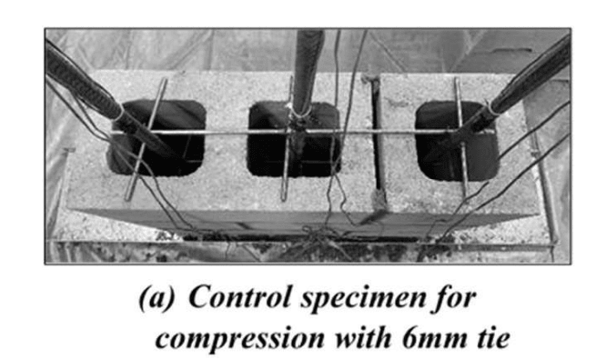

The research paper behind the product explains the philosphy in more detail.
I understand the product proposes the block can be designed as 'reinforced' (ie restraint to the vert bars via the grout annulus) in terms of AS3700 capacities.
Upon further reading, it would seem there is a discrepancy in defition of 'tie' between AS3600 and AS3700.
What from I can tell, this is what AS3700 defines as a tie to restraint the vertical bars.
We had a large, 6 storey building project, all masonry, a few years back. It was the first project with the 2018 code adopted, as the contractor heard about the new capacities and wanted to take advantage of it. We explained the limitations, needing BlockAid or similar etc. The contractor was all on board, but of course the layers weren't. "We've never had to do this before" etc etc etc. The blockAid worked quite well at holding the reo in place, but does hinder concrete placement. The idea is that the minimum 20mm surrounding annulus of concrete provides restraint, so that the higher, Section 8 reinforced capacities can be achieved, otherwise you treat it as unreinforced.
