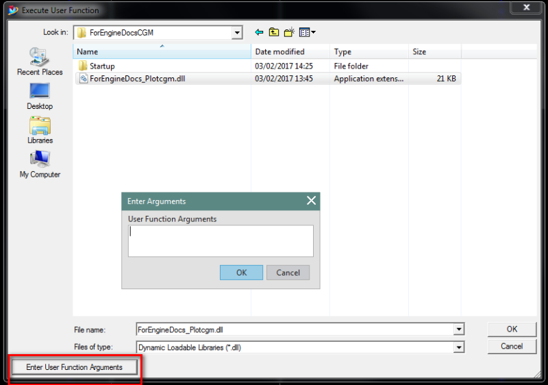

Hello all,
Has anybody ever tried to pass an argument to a dll started from a ribbon (or toolbar)?
I tried;
Code:
ACTION Start $SITE_PREF_PATH\ForEngineDocsCGM\ForEngineDocs_Plotcgm.dll Ai
And
Code:
ACTION "Start $SITE_PREF_PATH\ForEngineDocsCGM\ForEngineDocs_Plotcgm.dll Ai"
But I get the message from NX telling me; "Unknown Action Type"
To elaborate, when I run user fucntion from NX I can pass an argument as show below...can I do this directly on the Action line of the ribbon (toolbar)?
