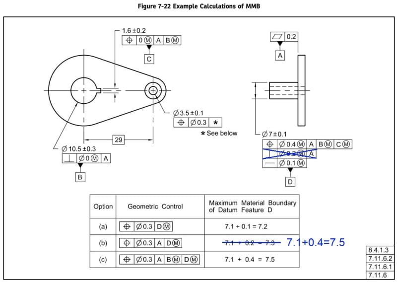

The ASME Y14.5 - 2018 says some words about choosing the appropiated MMB boundary: "7.11.6 The appropriate MMB for determining the size of the true geometric counterpart for an external datum feature(s) of size is the smallest MMB that can contain the datum feature(s) of size while respecting the datum feature precedence.
About this I think I couldn't understand what does it means with datum precedence when choosing which geometric tolerance must be take account on MMB calculation. See the image below:
Focusing only on datum D from the mid big hole. The FCF says datum D MMB must be located or oriented to datum A (perpendicularity in this case). So when choosing which geometric tolerance must be taken account to calculate MMB must I search for geometric tolerances applied to datum feature D which also refeers datum feature D perpendicular to datum A? Is that what the standard calls "features precedence"?

Looks like training material, but I don't know why the diameter symbol is not used before the position and derived median line straightness tolerance values for cylindrical features.
To answer your question, what you need to consider when calculating the MMB size is: what are the allowed variations in orientation, location, or both - for the specific datum feature, relative to the higher precedence datums as they appear in the feature control frame that applies to the considered feature that references this specific datum feature.
For example, when calculating the MMB of datum feature D for the 0.3 position tolerance control that references A primary, D(M) secondary, you have to consider the allowed variations of datum feature D relative to datum A. The 0.4 positional tolerance applied to datum feature D, which in this case also encompasses the maximum orientation error relative to datum A, provides a value to be added to the MMC size for the above-mentioned MMB calculation: MMB = MMC+Position tolerance = 7.1+0.4=7.5. This MMB value will be the size of the true geometric counterpart or datum feature simulator for datum feature D for the A, D(M) datum reference frame.

May I understand this way: If we remove the perpendicularity callout from Fig.7-22 2018 Ver. (this will be the same as OP's figure), then the MMB for option (b) and (c) will be the same as shown below. Am I right?

Now I got it. Thank boys. About the diameter on position tolerance zone I think it was missed. About the book it’s from Dave Slopsema who hosts the dimensional consulting web site.
