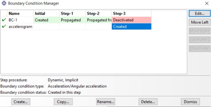

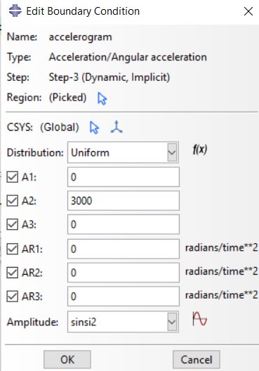

I have applied the Boundary conditions as shown in the photos.
in short, for the model with the step of implicit dynamic, I disactivate the Boundary conditions for the step of implicit dynamic, and applied another boundary condition which is totally fixed except for the horizontal DOF along which the horizontal acceleration is applied.

the preceding steps are,
1-initial,
2-General static (to apply the gravity )
3-Frequency (linear perturbation for modal anlysis).
4-Dynamic Implicit (to apply the acceleration)
both models are totally linear, NLgeom is off always.
