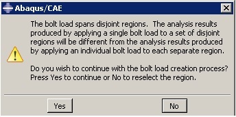

I am trying to build a model of a basement of a wind turbine which I will use in my bachelor thesis. I have two issues with the model:
I'm trying to apply mutliple bolt loads on 192 bolts. I am only able to apply one bolt load at a time. I already selected all bolts at the same time, but Abaqus gives me a warning.

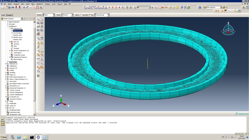

Another issue I have is the mesh. I am not really happy with my actual mesh. I tried to partition the part further, but he mesh still looks arbitrary.

Am I able to apply multiple bolt loads at the same time? And which method is the best for not getting this warning showed in my first post.
Do you have any advise to get a better mesh? It looks really arbitrary and further partitioning lead to a worse mesh.

In the past I have used a for loop to apply loads to multiple bolts because of this warning. I was using wires for bolts. The code is below, you may be able to modify it to suit your application.
Python:
#instance bolts and couple to flat diameter
for n in range(NB/4):
	x=cos(pi/180*(360/(2*float(NB))+n*360/float(NB)))*C*0.5
	z=sin(pi/180*(360/(2*float(NB))+n*360/float(NB)))*C*0.5
	y=t+rf
	#place bolt
	bolta=myModel.rootAssembly.Instance(dependent=ON, name='Bolt-%s' % str(n+1),part=bolt)
	bolta.translate((x,0,z))
	#bolt loads
	bmid=bolta.edges.findAt(((x,0.5*y,z), ))
	bloc=myModel.rootAssembly.Surface(end1Edges=bmid, name='Surf-%s' %str(n+1))
	myModel.BoltLoad(boltMethod=APPLY_FORCE, createStepName='Bolt Up'
    , magnitude=SAb*RA, name='BoltLoad-%s' %str(n+1), region=bloc)
It is tough to comment on the mesh just from the photo. My latest version of Abaqus is 6.14-1, so I cannot open your CAE. Photo below shows my first thoughts on the mesh.
