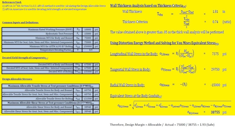

I am new to designing gate valves to API 6A 21st edition standard.
In the process of performing design calculation, I have few questions for which I am looking for answers.
1) When defining the design allowable stresses for pressure vessel calculation or wall thickness sizing, I am using API 6X method to calculate the design allowable stresses ie., 2/3*Sy for working pressure and 0.9*Sy for Test pressure conditions. But for the main calculation, i am following Von mises equivalent stress method or distortion energy theory method by combining triaxial stresses. Is it allowed to mix these two methods to arrive at equivalent stress?
2) How to calculate the allowable tensile stress? I have found through online resources that had .83*Sy to calculate maximum allowable tensile stress for body , bonnet, gate, seat, stem, and misc components. The calculation results were compared to this allowable tensile value to arrive at FoS.
I couldn't find anywhere that .83*Sy will give an allowable tensile value? is this correct or please let me know if otherwise.
3) Is it necessary to do compressive bearing stress calculation for seat to gate and seat to body interface for a valve with gate/stem that has a threaded connection? the reason i ask is when using a T-Nut style connection with a floating gate this becomes far more applicable, but not sure for a threaded connection.
Thanks.

Hi Dinu,
Thanks for your reply. It was useful.
I want to use the distortion energy method, that is by combining the triaxial stress to obtain the equivalent stress.
As in API 6A 21at edition the ASME method part has been removed and replaced by API 6X ie., earlier it was ASME Method to calculate allowables, 2/3 Sy and 5/6 Sy as per 20th edition. This was replaced by API 6X now.
Therefore, what are the allowable criteria for using the distortion energy method? is it still 2/3 Sy and 5/6 Sy ?
or as per distortion energy theory should i consider SE = SY ie., design factor of 1 times Sy instead of 2/3 Sy and 5/6 Sy?
Attached is a sample calc i made using excel. Please can you check and let me know if its correct? Thank you very much.

Hi Jmec,
Thank you very much for the details. Actually the question was to calculate for a valve body.

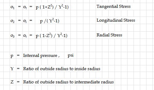

For straight uniform cylinders, I'm using only the principal stress formula below to calculate this.
Where LStress - Longitudinal stress, TStress - Tangential and RStress - Radial stress.
and to arrive at a factor of safety, i use the API6A section 5.1.3.3 criteria for hydrostatic shell test condition, i.e., i would do use YS = 1 Sy

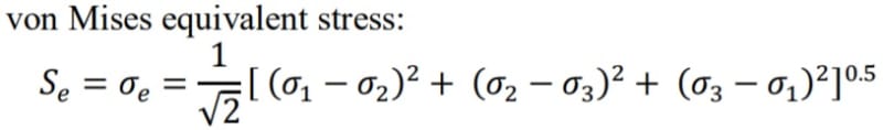

and for Non-uniform cylinders, I will be using the von mises combined stress formula which is as per API 6X shown below
and to arrive at a factor of safety, i use the API 6X criteria for hydrostatic shell test condition, i.e., i would do use YS =.9 Sy
Factor of Safety = YS / Von misses stress, is this methodology correct?.
Also, for Non Uniform cylinders how to calculate the direct stress x,y,z and shear stresses at the points xy, yz, zx ?
please let me know if there is any formula for this or where i could refer. Thanks
Hi HansonBoye,
as i want to say that you can use API 6X method for body thickness calculation. since API 6X is also referred ASME Sec VIII Div 2 Appendix 4 : 2004 Edition with 2004 & 2005 addendum errata. it is nothing but principal stresses. This will be quite easy to find the results for Non-Uniforms Bodies.
I can give some Ideas / steps to find the results...
Step 1: find out the allowable stresses from the material yield for both Design and Test pressure by Sm=2/3*Sy and St=5/6*Sy.
Step 2: Find out the Principal stresses for the required portion by using ASME sections along with Body ID, OD & Thickness as inputs .
(Note: You can find out the Z & Y formula in ASME Sec VIII Div 2 Appendix 4 in 2004 edition. For Z&Y, inputs will take from Body ID & OD, Thickness from the drawing)
Step 3: The above attached fig formula is a reference and you have to find out these three stresses for both design and test pressures.
Step 4: Calculate the Stress differences from the above principle stresses to find the maximum stress intensity (formula reference ASME Sec VIII Div 2 Appendix 4 in 2004 edition).
Step 5: Find out the FOS by calculated stress intensity for both design and Test pressures; i.e.) FOS= Sm / Stress intensity for design pressure & FOS= St / stress intensity for test pressure.
This is just an idea. hope it will help to take ur calculation further better...

Hi Dinu,
Thanks.
How about this....
I tried the below as per API 6X Combined Stress. Which says stress intensity,
Si = S1-S2 (S1>S2>S3)
Therefore I calculated the three principal stresses as per Roarks formula as below,
And found the difference between maximum and the next available minimum and then the
FoS = Allowable / stress intensity
This I did for both working pressure and test pressure condition.Hope the above method is right? And this is also acceptable as per API 6X?
Hi HansonBoye,
Yup It is accepted by API 6X as well as API 6A.
also noted that the allowable stress intensities for FOS, have to follow as per 5.1.2 in API 6X for API 6A product.
Thanks... all the best!!!

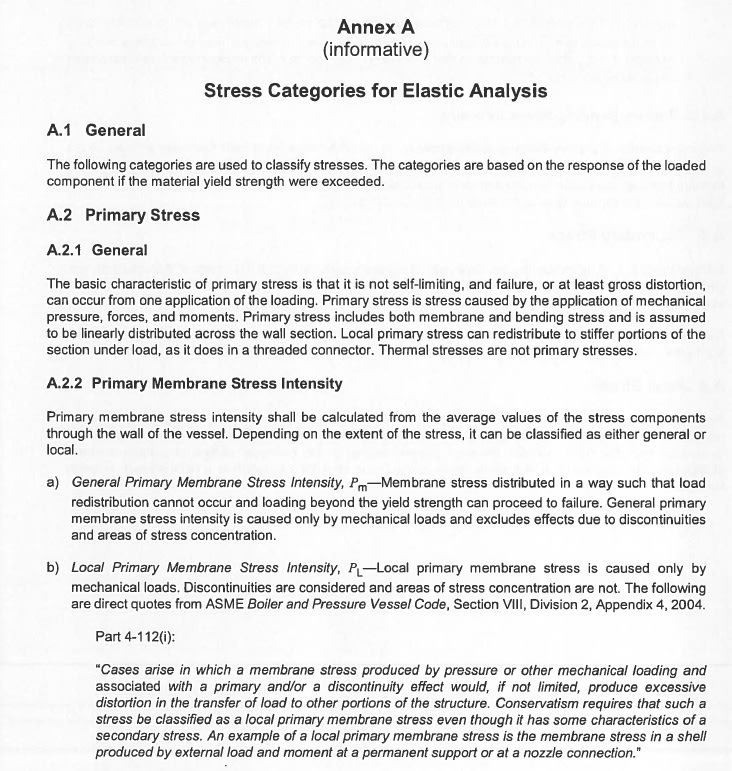

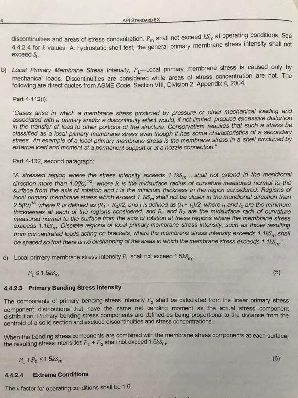

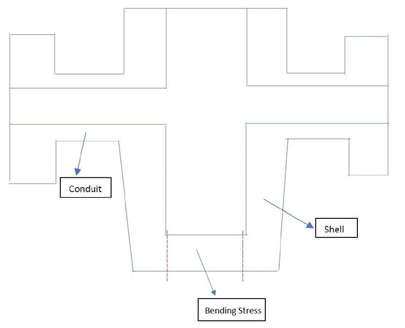

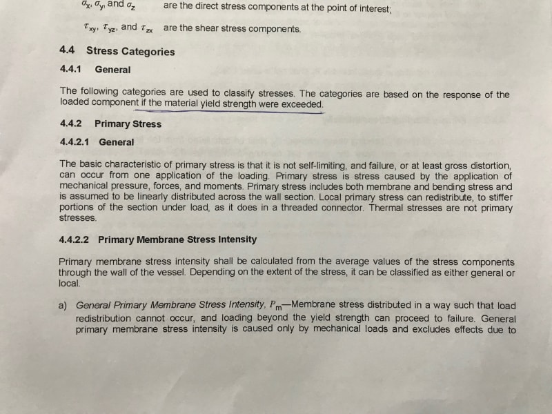

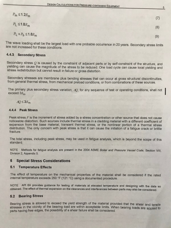

As per the API 6X second edition. Section 4.4 Stress Categories, is it mandatory to calculate the primary + bending stress? and the secondary, peak stresses?
The reason I ask is the section 4.4.1 says that the stress "The categories are based on the response of the loaded component if the material yield strength were exceeded." Below are the references from API 6X Second Edition.
Please let me know if you using these in your calculations?
For example: for the gate valve body shown below, for wall thickness analysis at Shell and Conduit, i only calculate the von mises equivalent stress as per distortion energy method and stress intensities as per roarks formula that we discussed sometime earlier. In this case i would calculate the primary + bending stress for the shell as there would a bending stres at the shell bottom as shown in the pic below? i dont see there is any bending load acting on the body conduit.. or in reality we dono where the gate valve will be used and what load will be on the conduit flange (API 6A spec). Kindly let me know if im correct, if not please clarify.
Sorry for the long message... hope you can clarify .. thanks

Hanson,
I had a quick review and i have found, attached photos is not the latest standard edition of API 6X.
it may be a draft copy / previous edition which cannot be used. also the underlined sentence is given in the annex as an informative in the new edition which is clearly stated as optional (No need to follow / need to follow)...
Please try to read the new latest edition of API SPEC 6X...
For reference: Index page can download and compare with your current 6X standard...
I will have look on your post once again and give my suggestion as much as i can...
Thanks and sorry for taking further more time to think about this...
Dinu...
There are no secrets to success. It is the result of preparation, hard work, and learning from failure.

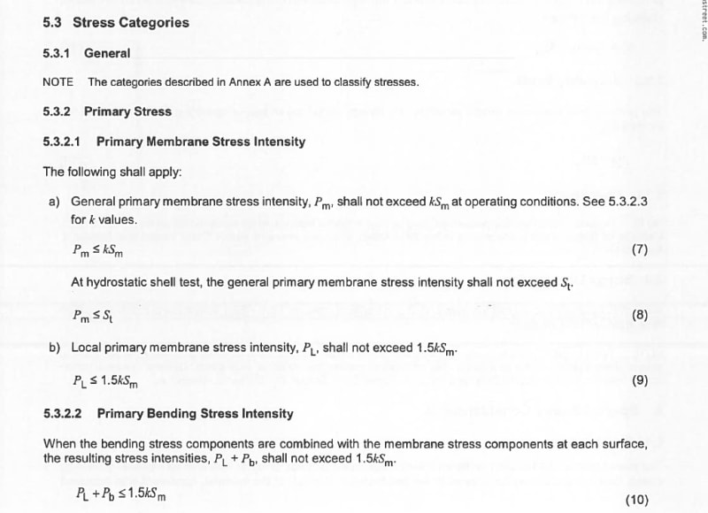

Hi Dinu,
Yes you are right. I was looking into the API 6X first edition instead of the Second.
But still, in the second edition they called it as informative - an additional reference to the main content Section 5.3 Stress categories.
But in the main section, they didn't say its informative ie., in section 5.3 they have given an overview of the stress categories with reference to Annex A
In general, in API terms anything informative is not mandatory and no need to comply. But as the general note in Annex A says "The following categories are used to classify stresses. The categories are based on the response of the loaded component if the material yield strength were exceeded" we can comfortably neglect these i guess.

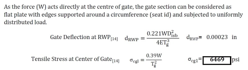

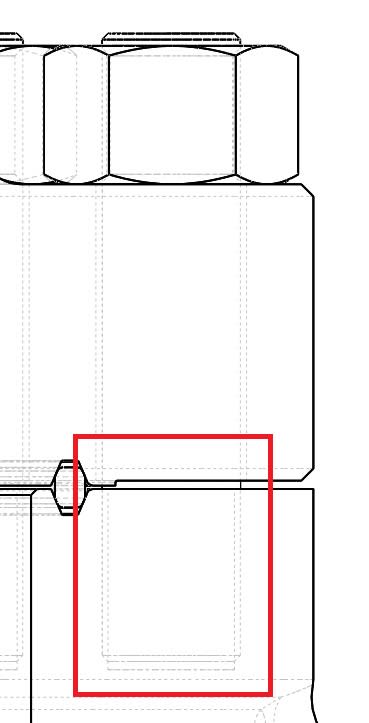

I have three more questions to discuss...
1) For the gate valves ..parallel slab gate..to find the gate deflections what method are u using? Although there wouldn't be much deflection on the gate, I'm using the deflection formula from Machinery Handbook (see below)to justify this as a supportive calc. Where W is the force due to upstream pressure acting on the gate at the gate and seat interface.
Do you think this is required?
2) For the body bonnet bolt stress, i go only as per the ASME VIII Div 2 method of calculating the bolt stress at operating conditions and gasket seating condition. My question is doing so, we aren't calculating the capacity of the body itself to withstand the bolting stress produced. How to justify if the body can withstand all the stress due to bolting force. I mean in the body section area shown in the below image.

2.For Body Bonnet Bolting, ASME Sec VIII Div 2 method is OK... but you have to consider the total design pressure for the calculation. if you follow ASME section VIII Div 1, there will be a formula which includes stress constants and rated working pressure. (i will send the detailed steps once i get time... give your email id or please send an email to haidinu@hotmail.com)
