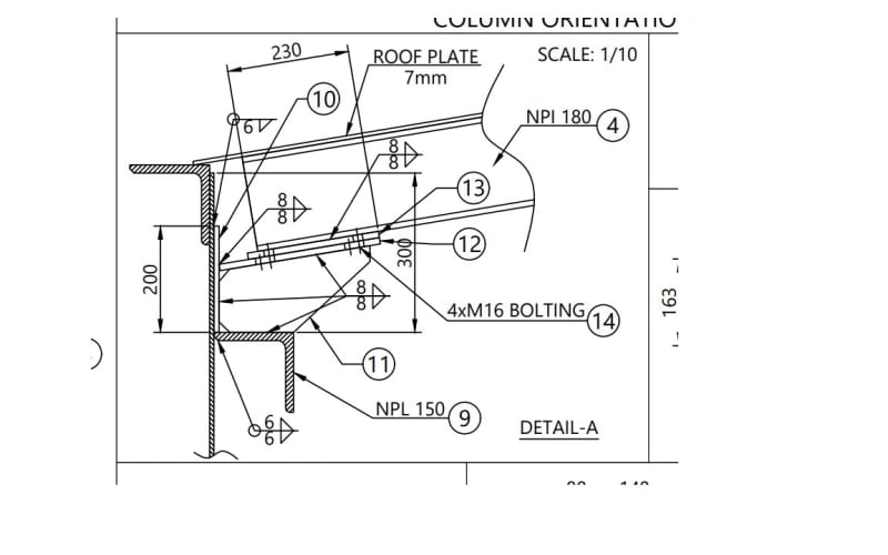

I checked all the API650 if there is any Limit for non-frangible tank’s roof designed but there is no such limitation. For your understanding initially I planned to use angle L NPL150 with dimensions 150x150mm and thickness 15mm. But Net Area at Roof/Shell Junction including 3mm Corrosion allowance would be 6660 mm^2 only and shall be increased in 10 times to pass the calculation of required compression area at the roof-to-shell junction.
So my idea is to find The biggest top angle available on the market or to weld from plates any customized angle to get required compression area at the roof-to-shell junction 58 552 mm^2.

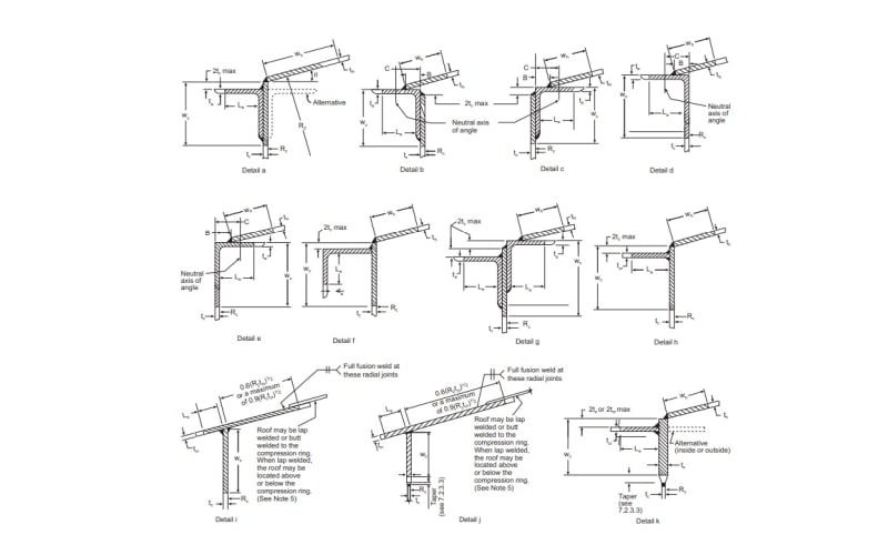

Based on API650 5.10.2.6 (Frangible roof requirements):
5) The roof-to-top angle compression ring is limited to details a through e in Figure F.2.

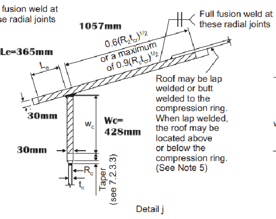

So as I understand this section of API if I will use Detail j Compression Ring design (see picture below) the design is not considered as frangible any more and I even do not have to weld rafters and girders to the shell plate?
I did calculation for detail j (I did not considered corrosion allowance for this high level calculation)
I took wall thickness of compression ring sheet equal to 30mm. Please see on the picture dimensions which I got.
I calculated Compression Roof/Shell Junction Area as per Section F.5 and got A=59412 mm^2
So the calculation is passed! But I understand that it is very difficult to weld and bend 30mm thickness plates...
Also I can increase roof to horizontal angle. Initially it was 9 degrees. If I increase it to 12 degrees I will reduces required area ин 35%!
Is my understanding correct?

I used compression ring detail J (30mm thickness see my sketch above). Roof plate 7mm wall thickness (incl. 2mm CA) with compression ring detail J as per my sketch fulfill Appendix F API650 requirements. This approach is not easy to implement but it is cheaper than use of 25 mm roof plate.

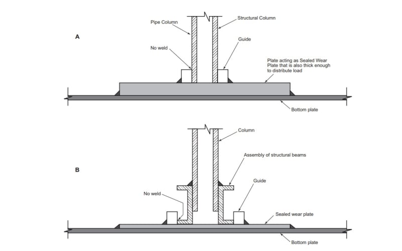

The internal pressure will lift the roof plates, and with the rafters welded to the roof plate, these will lift as well. Assuming the framing system is welded together, including to the support column, you'll then lift the support column !!!!!! So now you need a system to keep the column returning to the proper position when the pressure is reduced. All the framing system welds must be designed for this "hanging" load condition. If you suggest that you won't weld the rafters to the rest of the framing, then what prevents the columns from falling over, and how do you accurately get the rafters to return to the same positions on the framing?
I have never designed a high-pressure tank with a supported cone roof. I have no idea how I would provide a different compression flange bracing system.
Is there a reason why you have to stay with a supported cone roof? I don't think you've mentioned how tall the tank is.
Since you are looking at the shell-to-roof joint and are not wanting it to buckle inwards from the radial component of the roof plate forces reacting to the internal pressure, would it be possible or reasonable to install a windgirder up top? It can add quite a bit of section modulus...
Dear IFRs,
I have wind girders and even additional stiffener ring please see picture below:
As I know if doing the calculation in accordance to API650 Annex F only specified and shown on the picture below compression ring details may be used.
So wind girders cannot be included in the Compression Area calculation. Please advise

I understand your concerns regarding support column lifting. My idea was to use a guide as per API650 requirements. Please see picture below. The guide length may be increased to be sufficient for reliable column lifting.
