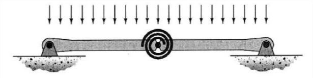

Anybody recognize this problem in any text books?
I don't recognize the photo. I'm guessing a statics textbook, or a structural analysis book.
It's statically indeterminate, which was not covered in my undergraduate statics class; so I'm guessing a structural analysis textbook.
Is that a "moment spring" of some sort in the middle?
I don't recognize the photo either. The structure would be statically determinate if the central pin was raised or lowered. In the first case it would be a 3 hinged arch. In the second case, it would be a pair of tension members. As it is, the structure is in a "fall through" situation where the members are changing from compression to tension, so an analysis would need to consider the strain of the members to determine the forces in the two members.
BA
Also reminds me of a plastic analysis of a beam. Where the bending spring in the middle has constant moment of Mp.
With two pinned ends, not one on a roller, it's a tricky plastic design problem, too... maybe a really stiff catenary? [pipe]
but the two pinned ends are not shown to be joined ... so maybe that releases the axial deflection ?
if no axial restraint assumed, then the solution is "easy" the moment at the CL is known, the spring will permit so displacement.
if axial restraint is active then a redundant problem, some beam moment is reacted by the axial couple.
I haven't seen the problem in a text, but the style looks "old fashioned".
As driftlimiter says it looks like the sort of mechanism you draw for a fully plastic frame, in this case 2*MP*theta=2*L/2*theta*W/2 or so.

Maybe this book...
Vector Mechanics for Engineers
by Ferdinand Beer (Author), E. Johnston
JohnRwals (Structural),
Thank you for your response. I appreciate it. However, I didnt find this in "Vector Mechanics for Engineers". If by the chance you seen it there I appreciate stating the edition and chapter that you found it there.

SKJ25POL, might one ask, where did you get it?
Regards,
Mike
