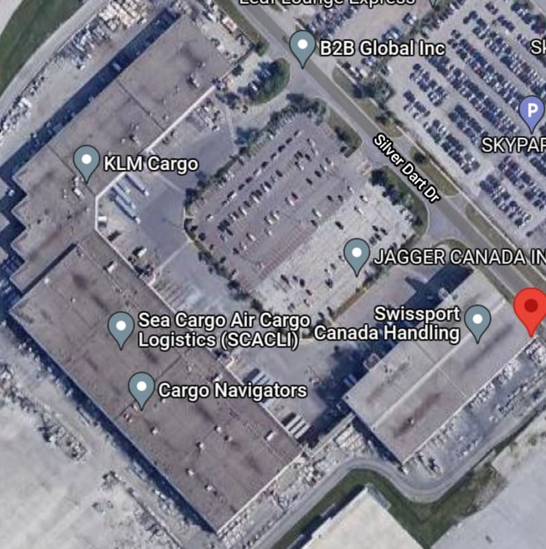

We just did a 400,000 sf Gerber style roof. I think you get a significant steel savings, but bracing the negative moment regions over the columns is a real pain in the neck, especially when you have bar joists.
And deciding on the patterned loading used to determine the worst case for the cantilever condition requires some judgment.
With plastic design, you likely would have saved more, specially for roofs with uniform column spacing. Pattern loading isn't so much of an issue with plastic design, it only affects the connection moments.
Both the building roofs were plastic design, the larger one was about 400,000 sq.ft.
