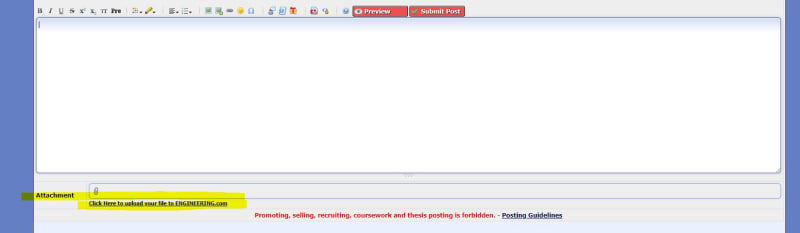

Dear Erik,
it's possible post the files? if yes, in which way?
Thanks!!!
Use any of file exchangers, Google Drive, Dropbox etc.
Also it is good form to tell version of Ansys and clear mesh and calculated data before creation of archive.
