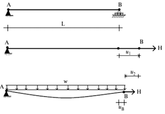

hope someone will help me beacause it's weeks since I'm trying to solve this problem without any sucsess and I'm quite frustrated, I'll be grateful for any kind of tips . I would like to simulate this process using LINK180 elements:
In order to have an idea of cables behaviour I read manuals and I've also seen examples present on the Verification Manual by ANSYS (where it is said that if you want to use LINK180 elements for cables you have to give them an initial small strain with INISTATE command and you'll have an initial system stiffness different from 0).
Aware that in the case of the picture I would get a parabola deformed shape, while if the load were applied along the lenght of the cable I get a catenary shape, these are my data:
final chord=L+u_b=304.8 m ; L+u1=312.73m (length of the cable after pretensioning)
E=131 000 N/mm^2 ; w=46.12 N/m ; A=548.4 mm^2
attended sag = f =30.48 m (got from a paper)
The value of H is set in order to get a specific sag around f, so H=17.57 kN (I got this value from parabola formulas, the catenary ones would have gave me H=18 kN, so there is no a big difference).
Initially I want to study a simple model, so I divided the cable in 10 elements, then applied the pre-tensionig force H (that I think is equivalent of using INISTATE command) and then, using a nonlinear analysis, I applied the dead load F at each node of the cable in a way that F*10=w*L

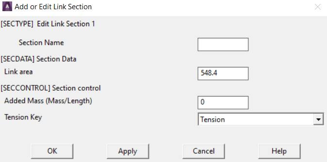

Then, as I'm working with cables, I set that they can resist only against tensile forces:

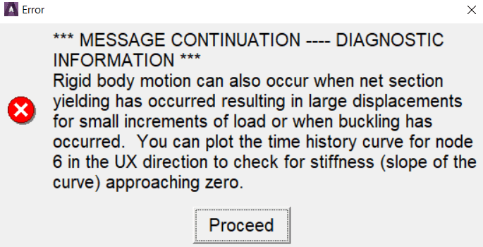

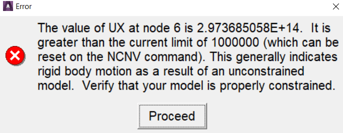

Then I set the nonlinear analisys (Automatic time stepping, ON; Line search ON (the manual says it is useful for flimsy structures); NEQIT=1700 ) but when I ask the software to solve it says the model is unconstrained:
Then, if I try to set tension key on tension and compression,the program runs and numerical sag not only is plausible but also, if I augment the elements (10,100,1000,4000,6000), it converges to the value typic of the catenary (34.0m ; 31.1m ; 30.9m ; 30.84m ;30.84m vs. 30.86 ). That is even more correct than the 30.48 attended sag that corresponds to a parabola shape.

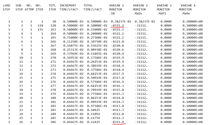

Remaining on tension-compression case, if I monitor UX displacement of one node (for example the 11th, last one) it seems that it initially goes immediatly left and then move slightly right while I thaught that they will only move left... I suppose that elements first go on compression and then in tension but this is not right.
Here's a screen of UX displacement of 11th node (where there's the roller) in wich I see that the displacement is decreasing in modulus instead of increasing and it makes no sense altough the final UX displacment (8244.8 mm) gives L+u1-UX=312.65m (initial cable length set in order to have a tensionend length of 312.73) + 0.0764m (due to pretensioning) - 8.244m = 304.48 that is exactly L+u_b=304.48 m

I was waiting for someone else to respond, because I know nothing about ANSYS OR LINK180, but something caught my eye and I'm wondering if it might explain the error message you are getting.
That makes sense, but I don't know why you need to specify that cables can only resist tensile forces. Cables cannot resist bending moment, which means that the deflected shape of the cable is similar to the shape of the bending moment curve for a beam spanning 'L'.
You should not have a roller at Point B. That would cause the program to consider the structure unconstrained if sag and horizontal force are also specified.
Point B should be a pinned support. Maximum sag can be specified, but not H. The software should determine H from the point loads applied. It may be better to try a larger sag in order to provide a little more variation in the nine F forces between supports.
