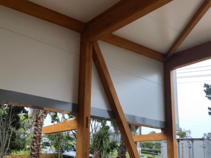

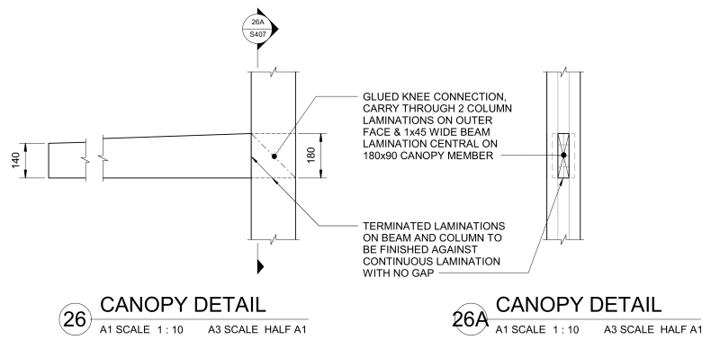

Last time I did something like this I used a glulam/laminated member and laminated the central ply right into the column, so it turned up as one piece. No fasteners needed. They were also doing glued/laminated portals on the job, so adding this in was easy. Architect had an aversion to using any visible fasteners on the entire job (came up real sweet though).
Had to design joint using fracture mechanics as it's glued, apart from getting my head around that it was fairly painless.
EDIT - photo of said detail
