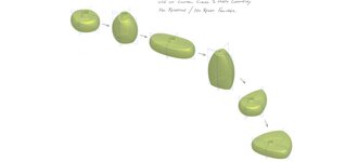

You don't have to reference anything other than a coordinate system in Creo, so in essence you don't have to have any references or relationships. I prefer to leave my features "loose" like that too - rather than reference existing geometry.
That's the whole point of true top-down design. You only tie geometry that is shared between parts (think conformal battery door on the back of a surfaced device) to datum geometry.
Referencing other geometry or other parts is not top-down design. That is painting oneself into a corner. I would rather have no references.
See the attached image of a "perfume bottle". There are no dimensions driving this model. There are a few control curves that can be pushed and pulled to morph the geometry.
Switch programs at your own peril. Creo is awesome.
