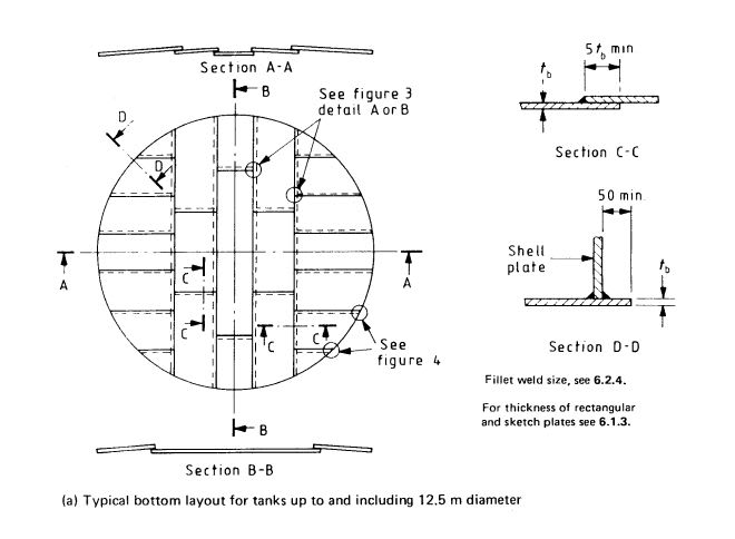

I am inspecting water storage tank which designed according awwa d100 and api 650 standards, 13.5 m diameter, sa 516 gr 70
In the original design there is an annular ring which ofcourse welded by butt weld and also bottom plates which are also welded by butt weld, the connection between them is lap welded.
The contractor wants to connect them by butt weld which means all the floor will be butt welded.
Is it ok according to api 650 or awwa?
Many thanks

I just looked to your post . You did not mention the thickness of bottom plates and annular plates. But i think both should be 6 mm. ( Minimum specified by codes ..)
I know BS 2654 which allows the use of rectangular and sketch plates ( without separate annular ring ) up to dia 12.5 m.
The relevant page copy and pasted below=
I will suggest similar set up with butt welded version if the annular plt thk. is the same with bottom plates.
The code allows butt welded bottom plates ( 5.5.1 thru 5.5.5)
