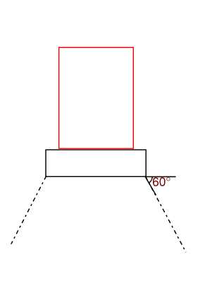

Hi all.
I have a question that has no doubt been covered on this forum but I can’t find a solution.
Does tabulated data exist covering the angle of dispersion through different soil types?
I am to believe (depending on what is being checked, i.e settlement etc) that the angle is 30 degrees to 45 degrees. Is this 30 degrees from the vertical ( or 60 degrees from the horizontal as shown).
I have a gravity retaining wall in bed rock and I’m trying to argue a steeper load angle through the ground beneath to avoid an adjacent structure.
Any opinions, discussion or assistance as always is welcome.
Luke
The distribution from you sketch is normally shown at a slope of 2 vertical to 1 horizontal.
