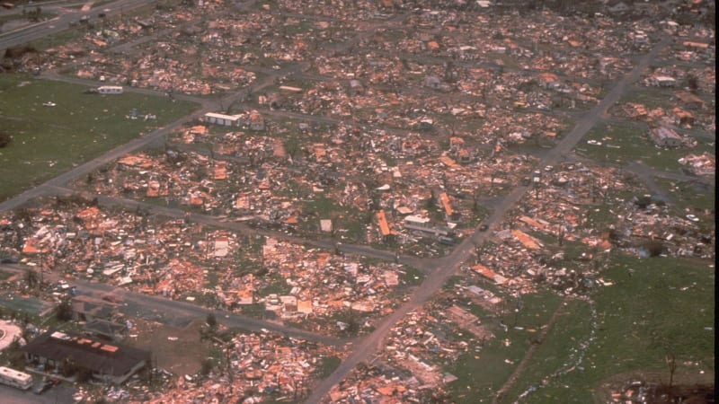

I bet most of these houses were built using "standard practice." Just sayin'.
