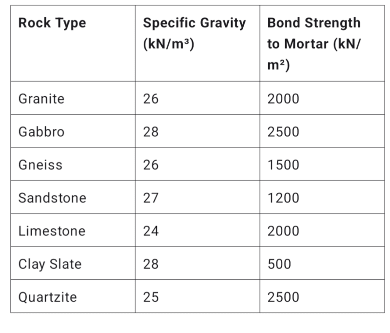

Not sure if applicable, but here's a table for bond strength to different types of bedrock. Copied and translated (chatgpt) from a Norwegian guideline for bedrock anchoring.
