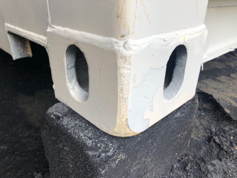

I'm afraid not. The calcs for the pool superstructure weren't terribly inspiring. And the anchorage guidance so far has been:
1) "Here's a pic of the base lug."
2) "It might not need to be attached at all but you should check local requirements."

That being said, it appears to already be in the ground
No, the picture is a very similar pool but not my pool. Plenty of time to sort thing out.

FWIW... the lug thing. Pretty beefy although I was expecting a horizontal base plate of some kind. Thankfully, we wont be supporting he pool one some pieces of... pumice?!?
Looks like they took a shipping container and waterproofed it.

If aesthetics/trip hazard allows, maybe I could post install some angle clips around the lug just to act as "keepers" after a fashion
That was my first thought too when I first read this yesterday. I see it more as a property damage prevention issue than a life safety issue, and retaining clips would be cheap insurance for the owners to hopefully prevent major damage. I would leave a little space to still allow the pool to slide around a little bit to dissipate some energy through friction.

Wow. A shipping container pool.
Agree with adding some twist locks. if they're using a shipping container then no point reinventing the wheel.

It's sounding more and more like the angle to keep it from sliding is the way to go, assuming it can get anchored appropriately.
Some good information and details for connecting and anchoring containers here and here.
