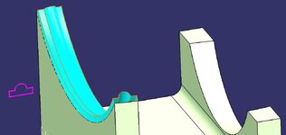

Let's start with this little example below: we have a support bracket and we need to add two gaskets on the upper curved surfaces. Both of these surfaces are complex with varying angled slope, and varying widths. I've drawn the profile of the gasket in red.
Example 1:
To begin, I have very carefully drawn a sketch of the profile of my gasket. I have constrained the profile with two bottom corner points coincident with the edges of the surface.
By constraining the sketch to the exact location, we don't need to use Anchor Points. We can make the Swept Surface by just choosing the Profile sketch and the two Guide curves.
Clicking OK, we can see the resulting surface. If we zoom-in, we can see how the surface has twisted and stretched in order to sweep the surface with the two corner points following the Guide curves.

continuting on.....
Example 2:
We could do the same Swept Surface a little easier if we use Anchor Points! I've drawn a new sketch of the profile, but this time I just drew it out in space with no relationship to the Guide curves. (If I had a Catalog of profiles, I could have easily copied the sketch from there)
This time, we can make the Swept Surface just like we did earlier, but we will choose the Two Points option, and we will select the two bottom vertex points in our sketch. Make sure the points are selected in order, with the first Anchor point aligning with the first Guide, and the second Anchor with the second Guide
Clicking OK, we get the Swept Surface. The same (or similar) to the first example, but this time with using the much simpler profile sketch.
Hopefully, this shows how Anchor Points can be used to position the profile relative to the Guides.

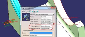

Example 3: using Anchor Points with a Swept Surface
Now we want to add another gasket on the right side of the support. Instead of drawing another sketch just like the first one, we can just use the first sketch again!
Just like before, we can select our profile, and the two Guide Curves. To maintain the same dimensions as the profile, choose the option Point And Direction. The first Anchor Point will position the profile with the first Guide curve. Select a line in the Profile Sketch which will rotate the profile in the direction of the second Guide curve.
And here is our Swept Surface. Zoom-in to see that this surface twisted to follow the Guides, but it kept the same size.
If the surface is flipped around, the Anchor Direction is probably pointing the wrong way. To fix this, double-click on the surface to edit it. Choose the Position Profile option on the very bottom of the menu, and clide the option to invert the profile extremities.

Doubt 1: When I pick anchor point (vertex 10 of sketch 6), where is it located in the guide curve. I mean it can be assumed by catia that the anchor point is at the beginning or middle of end of guide curve. How is this controlled?
Doubt 2: The sketch to be swept (sketch 6) is oriented with guide curve so that the anchoring edge becomes perpendicular to the guide curve. Is what I understand correct?
Thanks a ton!
The Anchor point is calculated based on it's position to the Guide curve within the sketch plane. It will be swept from the beginning to the end to make the surface.
Each section of the surface is oriented based on the spine.
