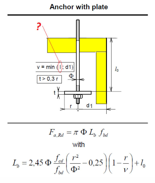

BS EN 50341-1 : 2012 : according to the figure, can anyone tell me to what is "l" referred(red marked) ? Thanks
Shot in the dark here, is it the min of l0 and d1 and they just missed the 0
