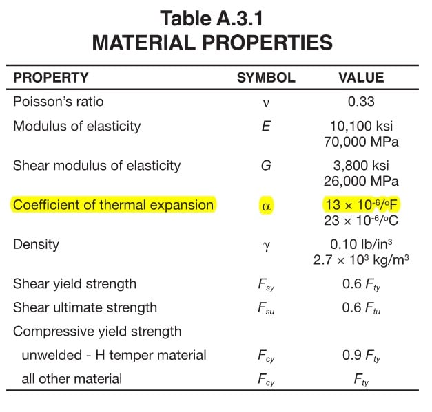

Per the Aluminum Design Manual the coefficient of thermal expansion is 13 x 10^-6/Degree Fahrenheit. If you were to provide a single fixing point on one side of the upper panel flange then the pane would expect to experience a 0.00936" growth over its 5'-0" length at a change in temperature of 120 degrees Fahrenheit. Your 2.5mm expansion/contraction gap would work in this scenario. In my opinion you can accomplish the expansion/contraction accommodation with oversized holes on one flange as long as you provide sufficient room for the panel to move based off of your design change in temperature.
