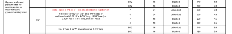

I am looking at the ANSI/AF&PA SDPWS - 2008 Table 4.3C
Does anyone know if you are allowed to substitute a screw with the same diameter and length for a cooler or wall board nail?
