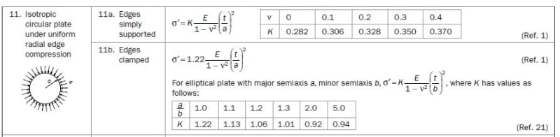

Hello,
May anyone advise that the allowable compressive stress (Euler's formula) for a circular flat plate (steel) under uniform
radial edge compression?
Thanks,

Formulas for critical unit compressive stress in case of a circular plate under uniform radial edge compression can be found in Roark’s Formulas for Stress and Strain. But they are different depending on boundary conditions - whether the edges are simply aupported or clamped.

I request the ALLOWABLE criteria to validate the buckling rather than how to calculate the compressed stress by Roark’s Formulas.
Pls find the excerpt from Ref. Roark’s Formulas for Stress and Strain;
I have the paper book, but somehow and somewhere I found in internet a PDF copy of the 2nd edition (the one I posted). I You are lucky, may be You can find it, same as I did
