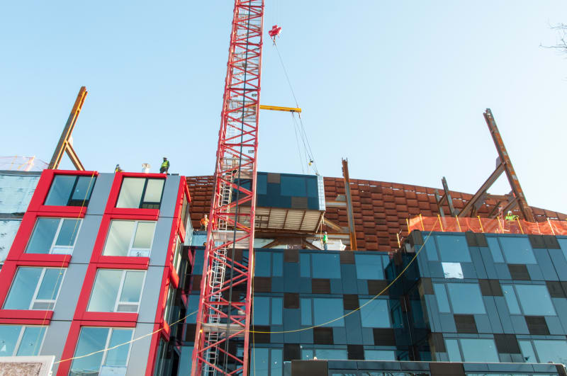

@Deker - Yes, that makes sense in general. I'm looking in particular at modular construction and how it satisfies this requirement. It seems clear that it does not but I'm digging around to see if it's that simple, i.e. they just ignore it on the basis that there's a lot going on here that makes the spirit of that requirement not applicable, or there was some codified exception. Until now I always thought that the 4ft was a recommendation not a requirement so I was hoping someone would note an exception. As an fyi, this is an example of the modular I am talking about. The vertical connection between stacked modules is a single bolt, very minimal. There's a slideshow you can click through, pretty neat.

I looked up atlantic yards and it's kind of a new approach of modular construction. combined with a traditional structural steel podium and braced frames. I'm not sure what code path the design team would have followed for this, but it's pretty novel. Almost like a giant storage rack system for human dwelling units. Construction photos here:
@Bones - That was novel(ish) at the time but has since been replicated quite a bit. Often they go ahead with concrete cores and use those in place of braced frames. Either way the modular columns still act as columns, and are governed by aisc. I have quite a bit of info and drawings on that project and others. The connections between adjacent modules are typically done on top and consist of plates and various diaphragm type connectors, but vertically there is often a very minimal connection such as s single bolt.
I guess if it was my project, I’d take the R = 3 approach and hope the AHJ bought off on it. What do the drawings indicate for seismic resisting systems?
That is pretty neat. For modular construction with a single bolt at each corner, perhaps they are considering frame action of the module resolving the column base moments into T/C couples at the corners. With tight drift control on the SFRS, I'd guess that it wouldn't be too difficult to design the frame and corner connections to remain elastic at the imposed drift.
Perhaps you could also argue that these should be characterized as column bases, and with single bolt connections not providing flexural continuity of the columns, there is no engineering basis for shifting the connections away from the floor level.
