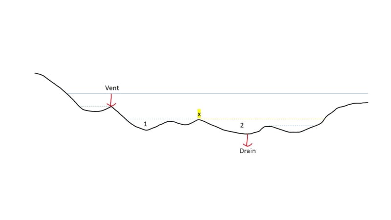

The issue with under pressure (negative atmospheric pressure) is that I don't want to fall below 0.3 bara. To explain my concern, let's add another example with only 1 drain and 1 vent (not a real scenario but to understand the effect):
-> blue solid line = initial head (after draining into the tanks)
-> blue dashed line = ideal final head (after draining over drain)
-> assuming that there is not other air source except this one vent and no other possibility to drain except this one drain.
Question: Is it possible to drain the volume 2 (yellow dashed line)? In other words, does the vent still contribute air into the system despite of the sealing by intermediate highpoint X and the remaining water (volume 1)? Or is the volume 1 sucked out as well at some extent?

Jack,
In theory yes it is possible, but depends on the level differences between the high and low points along the route.
If the bottom of 1 to X is more than 9 to 10m then no as there isn't enough pressure to lift the water up the hill, even with 0.1 bara at X and the vent open.
Also once the water column gets to point x then air will start to bypass the water column leaving some water in place.
So even if 1 to x is >10m, some of the water in this section will drain below the level of 1 until the driving force (atmospheric pressure) can't overcome the static head between the water air interface and the net high point downstream.

There may be a way, combining siphon and velocity head, if you can drain the yellow section at a velocity high enough to climb the hill 1 to x, but there are siphon velocity limits. It is very sensitive to height difference between 1 and x.
If you really need to drain the line completely, you might alternatively try that by pushing spheres through the whole length of the line with a compressed gas, draining at x until the spheres arrive there, then turning the drain off and pushing whatever water remains to the end of the line.

Transient flow conditions are always difficult to analyze but I have some concerns based on the most recent hypothetical diagram and question posted about whether the vent to the left will serve to vent to piping to the right of the drain.
In the beginning static equlibrium exists so that the static pressure of the column of liquid to the right of the drain equals the static pressure of the liquid to the left of the drain an so static equilibrium exists. As the left side is drawn down the static pressure head of this side at drain location reduces so that the pressure at the drain will decrease base on the left side. For static equilibrium to exists the right side will also need to reduce in static pressure contribution at drain location. This can only be done by creating a vacuum in the right side water column which eventually will reach vapor pressure of the water as the left side continues to be drawn down. Wasn't this what was trying to be avoided?
When water draws down on the left side of the drain there will be instances where a negative siphon type pressure will be developed due to the column of liquid on the right side of the high point X pulling a vacuum on the liquid to the left side of point X. I can see that a vacuum/negative pressure can be formed on the right side of X causing a negative pressure less that atmospheric pressure that is acting on the fluid on the left side of X so a pressure differential occurs to keep pushing/moving the fluid over the hump at X. However my question is when the fluid encounters a long almost horizontal run on the left side of hump/humps, the air-liquid interface is vertical. In this case there is a static pressure difference between the liquid at the top of the pipe and that at the bottom of the pipe of 4 feet (DN1200 pipe). Will this cause the water at the bottom to flow backwards while air enters at the top which will break the vacuum and cause the pipe to not be drained fully, and just how much water will not make it over the hills? Also appears will also have issue of negative pressures forming in some areas which was what was trying to be avoided.
Since the diagram ends on the right, I assume, rightly or wrongly, that there is an outlet there, which can be used to let air into the pipe on the right thus preventing vacuum.
In your scenario, no inlet /outlet on the right, drawdown there will go to vapor pressure, however water from the left will then attempt to cross through the drain junction and enter the right side pipe as it attempts to reach the same level that it has on the left side and heads will always balance and drain equally on each side. But a fast drain rate might prohibit that.
As for horizontal pipe, draining rate should be done fast enough that the water will not have time to flatten out and allow a long horizontal water-air interface to form. If you get some large diameter clear plastic garden hose, you will see that it is possible to do it, if drain velocity is fast enough. But the right side would develop vacuum, if there is no air inlet possible where the diagram ends.
My understanding is that the entire pipeline is first drawn down into the downstream vessel as much as possible, In this case the water head is equalized at the end to be on right to the static height head of the downstream vessel and on the left to the same static equillibrium head. Then block valves at both tanks are close and the pipeline is drained. So the right side is not open to atmosphere but to block valve at shut in pressure before valve was closed, and the line is packed on the right.
Correct - no inlet /outlet on right so drawdown will go to vapor pressure on the right. No - water on the left will not tend to cross the drain junction because the pressure at the drain junction is determined by the static head of the water on the left, and the pressure head on the left and right must add up to be equal to the same static head at the drain. What will happen is that the water on the rigtht static head will always be in equillibrium with the static head of the water on the left.
The horizontal draining rate is only 0.25 feet per second, for 300m m3/hr in 48" diameter pipe, which is almost zero velocity for practical purposes. A large diameter plastic hose is still a small diameter (what 3/4"?) in this case there are intermollecular forces between the molecules in the hose and the molecules of the water to keep the water clinging to the hose and prevent it from flowing backwards - this is the principal of capillary action.
That would immediately put an undesired vacuum on the right side, so surely if the intent is to avoid that condition, a vent of some kind on the right is necessary. Least that is what I assumed. I don't know one way or the other.
"What will happen is that the water on the rigtht static head will always be in equillibrium with the static head of the water on the left."
There would be atmospheric pressure on the left pipe surface, but vapor pressure on the right surface, so there could be roughly +600mm difference in elevation on the right side of the 2 water surfaces, after any transients from column separation stabilise. And I can see at least some possibility of back and forth flow happening while the drain flow is establishing itself.
Without going into 2phase slug or bubble flow regimes, sure there is a possibility that a long air-water surface interface could form if high enough velocity is not possible. That would leave water at the low points, or puddles within the pipe. If a complete drainage is needed, spheres or squeege pigs with a gas chaser will probably be needed to push it out.
