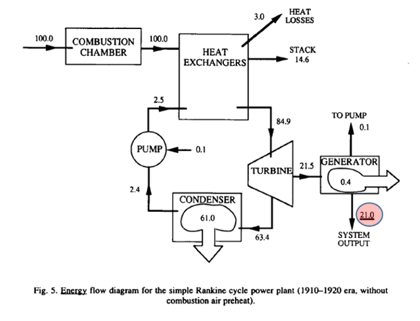

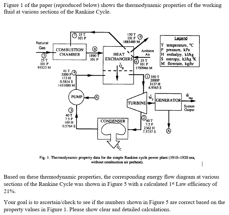

I am super lost here. I keep getting 26% thermal efficiency using first law analysis and cannot figure out what I am doing wrong. The paper I am using to help solve this problem is Teaching Power cycles by comparative first-amd-second-law analysis of their evolution by Dunbar et al.
Thanks in advance for the tips!
