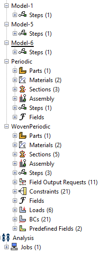

I create a new model and i only see the step subtree instead of the full subtree on other models. This is frustrating as can't quickly change workflow. I know I can use the top bar to get to the correct workbench. Is there any way to solve this issue?

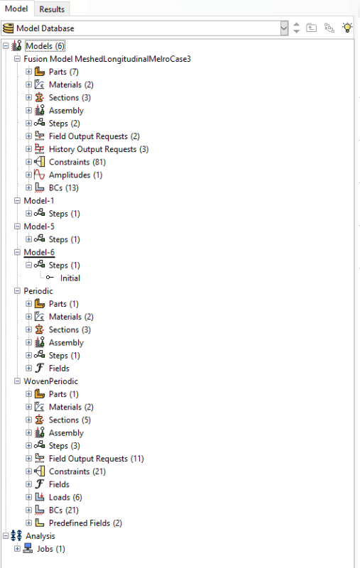

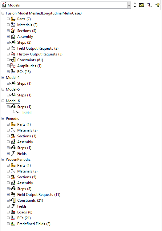

Try clicking the "Set Root to Model Database" button on top of the model tree.
When you click that button it should show "Model Database" instead of "Models" in the drop-down list. You should also be able to switch from there.
