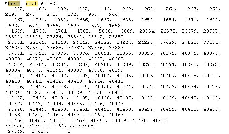

Hi. I am trying to run a model and it is showing this error. I have seen the .inp file and also reduced the name of things I need in the History output. The error is still there. Can you help me with this?
There’s a limit of 80 characters for node set name. You have to reduce it.
Thanks, FEA Way but I don't know how can I exactly do that. I have reduced the name of my surfaces, sets, parts, etc but still, it's showing this error. I'm a beginner so I don't know exactly how can I do it. Can you please guide me on how exactly I can do it? Thanks
Search your input file for NSET and reduce any long names associated with this parameter.

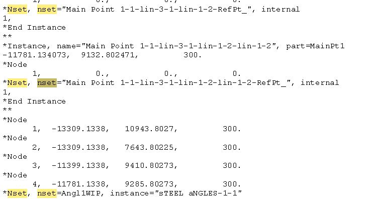

I am attaching two figures of .inp files can you please tell me where exactly is the problem.
Some of those node sets have quite long names derived from the instances to which they belong, maybe there are also others with even longer names. You should reduce them (together with references to them, of course). Check which names are longer than 80 characters.
