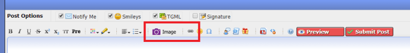

I have more images and videos but unsure how to upload
Look for the following at the bottom of your screen....
Otherwise, if the files are large, can you put them on a sharefile site and then link the URL with the link attachment?
