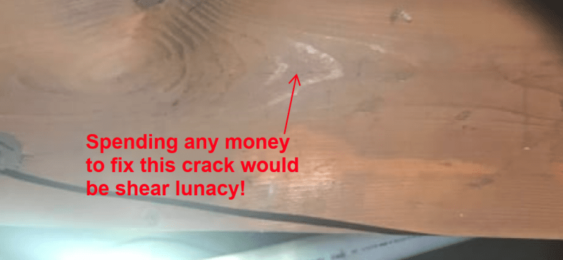

It's been identified that the main beam under a single story home that runs the length of the house has a hair line crack in it in the crawlspace. The crawlspace has a concrete floor. The main beam is 3 - 2 x 10s sandwiched together with 1/2" x 8" carriage bolts every three feet. The spans are about 9'-6" between piers. (Sorry about the bright flash at the bottom). We've measured a deflection of about 3/16". I hardly see any crack, and if anything it's just a hairline crack.
1. Is this crack something to concern with? When is a crack something to concern with ?
2. To shore it up and prevent it from deflecting any more we are proposing adding 2 floor jacks in between the piers. And sit each floor jack on top of a 2'x 2'x 3/4" piece of plywood.
3. Also proposing to add another 2 x 10 on one side of the main beam. What percentage extra strength would this add?
Is just one of the three boards in the beam cracked? The crack looks no worse than the knot hole(?) at the bottom of the front board and slightly to the left. If you are concerned, post up the triple board beam at the crack location.
The crack I’m talking about I don’t know if you can make it out in the picture.It runs horizontal the length of the board. I’m not concerned about it but this is a result of a dreaded home inspection. Now the Buyer is concerned.
You need to mark up the picture you previously included because I can't see any crack running horizontaly, only the vertical crack next to the knot on the top edge. Maybe the eyes are getting so bad that I can't see a crack anymore.

that shadow is quite confusing ... to me at least.
I don't see a horizontal crack, either. I would be concerned about jacking it up at the location of the vertical crack - you'd reverse the moment at that location and put tension right where the beam can't handle it.
Best bet would be to have a structural engineer put their eyes on it. I get calls for those all the time. It's a quick trip, assessment, and letter. It's not cheap, but it won't break the bank either.
If you zoom in the horizontal crack appears to run near the center of the beam in middle of the picture up to the compression zone on the right hand side. To be honest I would be more concerned about the crack at the top of the beam that seems to propagate about 1/3rd into the depth of the beam. Though at least it's on the compression side. Either case I wouldn't be too worried.

If a competent engineer is hired, and the situation on site is as you describe and show in the picture, then I wouldn't expect anything to be required. Wood splits and checks all the time, does not always mean the wood is failing.

That said, it is very unlikely that there is any substantial issue here. I would suspect if you retain a structural engineer their repair, if any, would involve a Simpson strong-tie reinforcement plate. Something like this perhaps longer depending on length of crack.

Yes, sistering on additional framing in a reasonable way would help eliminate any cause for concern, and that would be my recommendation if this were a concern. That should be possible to do without any demo or excavation. They got somebody down there to take the photo, and the work required is not that intensive. That 15K estimate is insane, and would potentially create more issues than are even existing. I am baffled that someone even gave that estimate.
Another simple solution would be to add a post and pier block at midspan of the "damaged" beam. Structurally, just look at the beam as two stacked beams and it should check out.

Checking is normal for wood framing. Strength is unaffected by minor checking. Repair will not increase strength and, in this case, is not warranted.
Below is an enlarged view of the crack in question. It is difficult to see the crack.
