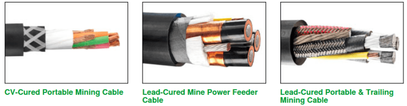

Shovel and mining cable, also used for crane (ship loading, and shipbuilding yards) trailing cable has a similar construction. Example
These products top out at about 15kV

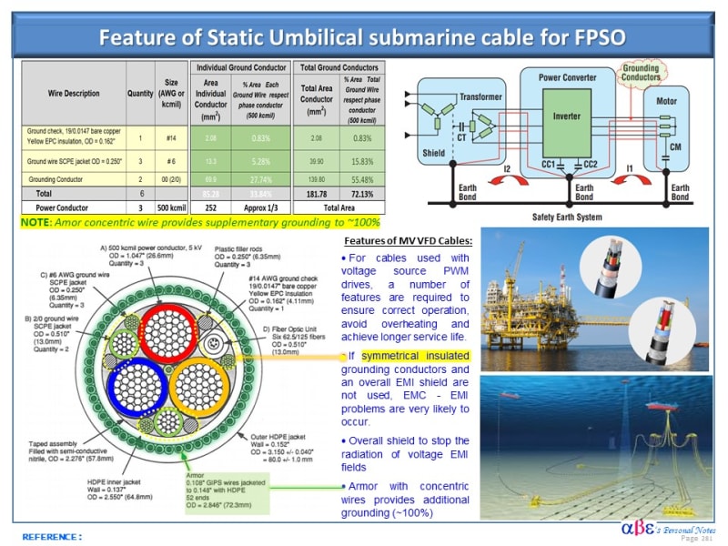

Is not uncommon to design an umbilical cable with full neutral size for application with a VFD pump or another motor load. One of the reasons for the oversize neutral is to reduce the impedance to mitigate electromagnetic interference (EMI), high-frequency electrical noise, minimize peak overvoltage due to static capacitance, avoid potential neutral overheating, and other safety and performance considerations, especially for longer cable length.
Below is an illustration of the cable indicating that just the grounding cable represents 72% of the 500 kcmil phase conductors. If the armored cable is added and other smaller grounding tapes, there is a good possibility that the cable is rated 100% neutral similar to the phase conductor.
The enclosed link and the illustration below contain some of the features used for an umbilical application that we hope helps to clarify some of your inquires.
@cuky2000
Excellent summary of the subject in the attached slide.
