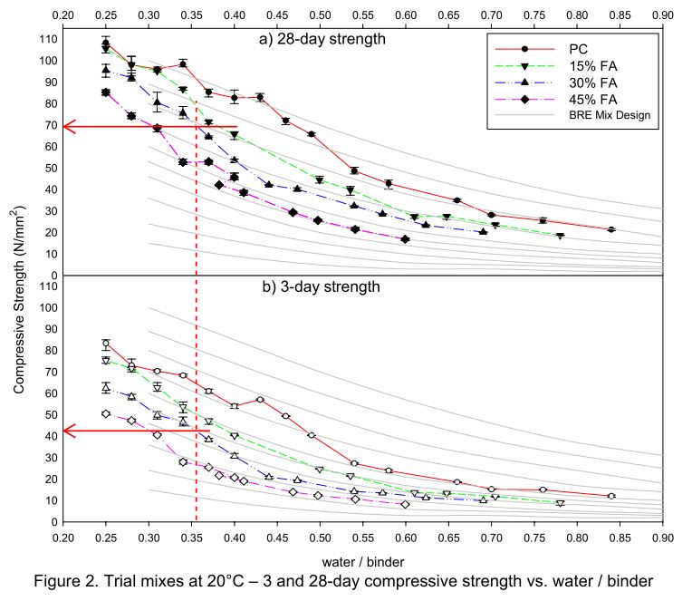

I have read many reported and design codes stating fly-ash equate to low strength gain, but this report clearly shows that is not the case, I really don't know which reports represent what I'm dealing with. We have decided to ask the GC to conduct early strength test (7-days) before we use the mix for a suspended slab.
The clip below is from the report for a 70MPa (10.15ksi) concrete trail mix, with a 30% fly-ash replacement the strength gain @ 3 days is the same as one would expect from PC concrete. I'm curious a bit as to why they didn't show a similar graph for 7-days strength, but 3-days strength gain is convincing enough.

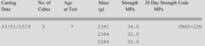

We just got the 7 days strength result for a 40MPa (5.8ksi) concrete, the result matches what the supplier claimed would be.
