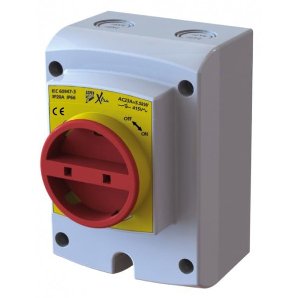

Hi all,
Q for the electrical gurus amongst you.
We are moving factory to premises which was occupied by a rubber seal manufacturer. We are thermoplastic moulders.
They are leaving wiring which was supplied their machines - some of it is ideally sited for our purposes.
Our machines are rated at min 21.5kW and max at 45kW.
Isolators in new place are rated 63A and 125A*, and the question is will they be ok for the required loading(s).
* What is the max load that can be applied to this if we wanted a bigger press on it?
Sorry for being dim, but there is a lot of conflicting stuff on the interweb!
Cheers
Harry

Hi Harry,
I imagine that the load will be almost purely resistive because it will virtually all be electric heating elements, which means we can disregard power factor. That makes it a nice easy calculation, but yes it would be good to confirm voltage and phases.
Assuming it's 400V 3-phase you can get an absolute maximum of 43.6kVA out of the 63A circuit, and 86.5kVA out of the 125A circuit. I personally wouldn't run either right up to the circuit limits, and you'd need to check the capability of your upstream service from the leccy board - probably 3x 200A fuselinks, but not certain by any means.
Hi all,
V = 415, 3Ph, N + E. 50Hz.
Load max is during injection phase (hydraulics), so rated figureis peak A.
An isolator is a wall mounted switch (near machine) which can isolate machine from the supply. No idea if it's regs but seems common practise over here.
Thanks guys/gals

Keith,
Isolator: usually a fault-making, load breaking switch capable of achieving a minimum contact separation in the open state and being secured with a padlock. This type of thing.
Oh, a disconnect switch or a fused disconnect. Got it.

Something to consider if you find a 45 KVA machine in a position where only 43.6 KVA is available;
Generally it takes a lot more BTUs, kWs, energy, (whatever you want to call it) to bring a product up to temperature than to hold it at working temperature.
Starting your injection motor may be even more problematic than running up to 45 KVA.
Consider having the controls modified so that the heating load is dropped off for about 10 seconds while the motor is started.
Don't start the injection motor until the product is up to temperature.
Once the motor is running, curtail the heating enough to allow the machine to run at less than about 90% x 45 KVA or 40.5 KVA.
Scotty calculated the KVA based on 400 Volts. At 415 Volts, 63 Amps will get you 45.28 KVA.
BUT BEWARE: If your machine is rated for 45 KVA at 400 Volts it will probably take more than 45 KVA at 415 Volts.
When the numbers are this close to 100% you may consider having someone competent look at and evaluate the installations.
There may be some important "It Depends" issues.
Bill
