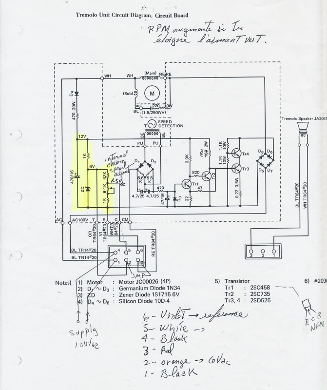

Yamaha organ instrument used to include, in some of their organ,
what they called a rotary speaker unit which is in fact
a rotating speaker driven by a pulley and an 120VAC-60hz electric motor
driven by a variable speed circuit. (the 120VAC is lowered for slower speed)
Here attached are pictures of the unit, The motor driver circuit and
because I just have all the needed material to build
a clone of this unit BUT the special Yamaha AC motor,
I use a substitute motor for my project..

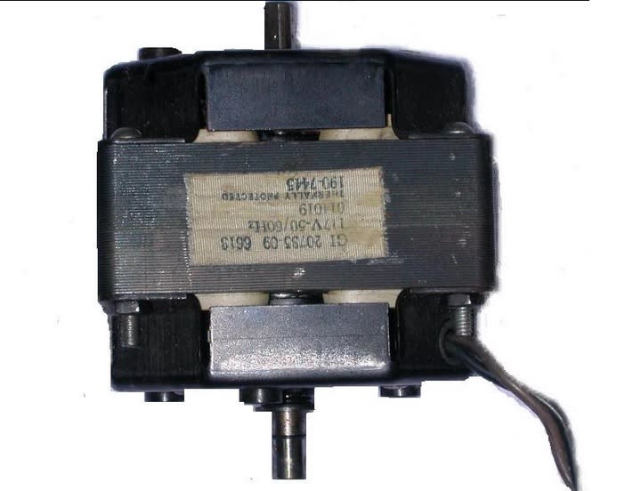

My problem is that my substitute motor which is the exact size/power
of the Yamaha is overheating when the VAC driving it is lowered.
I had to put a small fan over it to keep it from getting too hot !!
I suspect there is some windings in the Yamaha motor
that keeps the motor from overheating and accept
a lower AC than 120VAC..
Probably a current phase between stator and rotor
that gets 'upset' at slower speed than expected for 60hz use.. (??)

That is a special motor.
The "sub" winding appears to be a starting winding.
I don't see a starting winding in the picture that you posted.
What you cannot see is the squirrel cage winding on the rotor.
The squirrel cage winding on the rotor of the Yamaha motor will be designed for low speed torque rather than for efficiency.
From basic motor theory, the starting winding provides an offset magnetic field to start the motor turning and to determine the direction of rotation.
A shaded pole motor uses two shorted copper links for that purpose.
Given a constant torque load on a motor, the lower the applied voltage, the more Amps it takes to develop the same HP.
So, as you reduce the voltage, available HP goes down and heat goes up.
With the load characteristics of a fan, this is not a problem.

The diagram of the motor itself looks to be a PSC (Permanent Split capacitor), but I'm not clear on why one side of the circuit for it is going through a full wave diode bridge rectifier. Interesting...
I was confused by the diagram and the picture. I think that the picture may be the replacement shaded pole motor that gets hot.
I think that they are using T13 and T14 to control the current to the motor.
That does look like a diagram for a PSC motor.
I suspect that it has a special, high resistance rotor to give it something like design "D" characteristics.
Bill
"Why not the best?"
Jimmy Carter
The full wave bridge rectifier is to only keep the positive side of the 60hz waveform
to both TR3-TR4 and use them as a variable power resistor in series with the motor.
