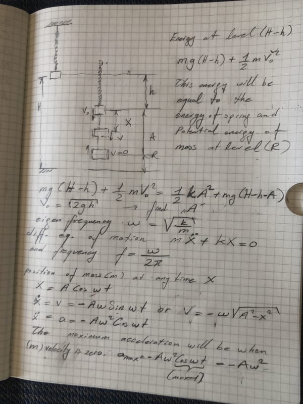

Correct me if i understand the problem wrong= a spring with ( k ) is attached to releasable hook at level of mass is H , and there is a mass m attached to the bottom of spring with k attached to a releasable hook at the top and a mass (known m) attaches to the bottom. The releasable hook detaches, the spring and mass fall together a set distance (h) and the spring engages and extends an unknown A. and the question is, What is the acceleration of mass at any position?
Assuming the mass of spring is negligible and undamped Free Vibration, the motion will be Simple harmonic motion.
With energy approach, knowing the total energy is conctant, and X is the distance of mass at any time after the spring engaged,
Velocity of mass when the spring engaged Vo=sqrt (2gh)
KE of mass whenthe spring engaged KE =(1/2 )M*Vo**2
And remaining of calculation i worked on notebook and picture is below:
