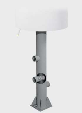

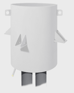

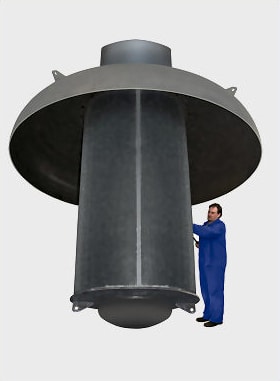

It is possible to feed different flows into one silencer, even at simultaneous flow and different inlet pressure.
This can be achieved with diffuser pipes.
diffuser pipe
collecting pipe
silencer with two inlet diffuser pipes
www.ventsilencer.com
