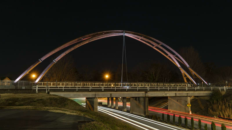

First thing that sticks out to me are the guy-wires at mid-span. It seems like a pretty inefficient arrangement, the slope being about 1:5 or thereabouts. I would have thought that this kind of structure would have been proportioned so that the end supports would be enough to make it stable under wind.
The guy-wires kind of ruin the aesthetic of the arches being otherwise free-standing, and I wonder if this came late in the design? Certainly the pier crosshead was designed to be wide enough for these.

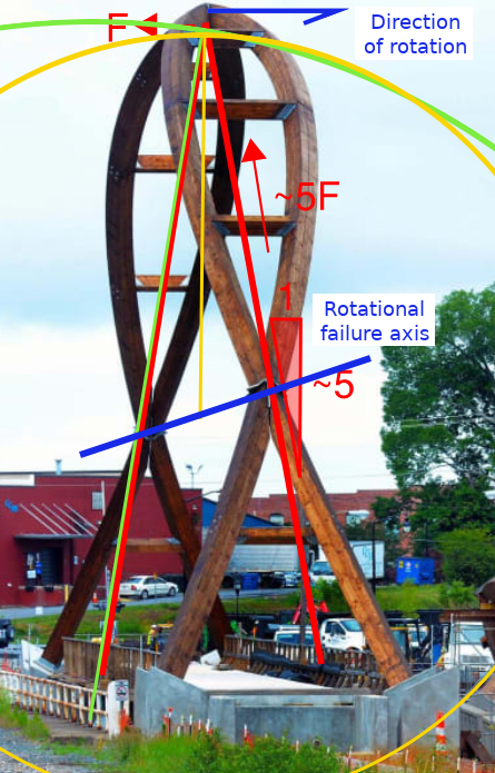

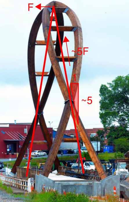

Even worse, with the hinge points approximately 1/3 the height, the guy wires become even less effective, maybe just enough resistance to tease the installation.

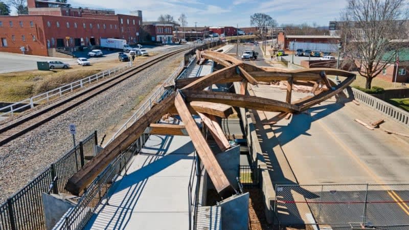

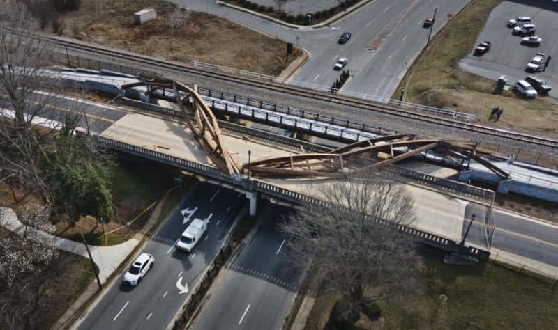

As we can see in these images, the top portion buckled from the hinge points while the ends fell inward.
Note that what you see in the picture with all the colored lines and circles and arrows is NOT the completed structure that fell down.
spsalso
Note that the complete structure includes two arches, one within the other. The failure axis extends through the hinge points on both arches. This is a very bad, no good, horrible design.
