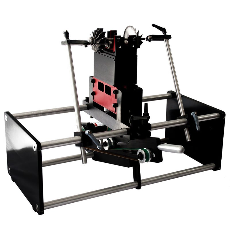

I'm currently balancing micro-turbine rotors using 2 plane balancing method. ISO1940 G2.5 requires a quality balance limit of 0.033mm.gram per bearing location in my case (100,000rpm), which I'm finding near impossible. Is ISO1940 limits a bit of an overkill? The best I can physically achieve is an order of magnitude higher (0.33mm.gram).
I have updated with an image similar to what I'm using. It appears that there is always some residual mechanical vibes present. The bearings have been changed to quality Japanese bearings which have little play in them. Also the balance cradle has some play along the shaft axis so the cradle isn't too over-constrained. The turbine is driven by compressed air at around 3000 RPM. I find this works well enough to see vibes in the system.

That whole thing looks far too flimsy to deal with excitations at 1 kHz plus. That is, you'll be exciting resonances in all those bits of metal.

Hi Greg

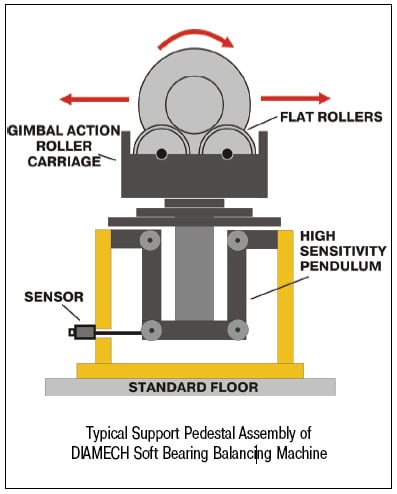

Its a soft bearing balancing cradle. Its mean't to be flexible enough to allow the rotating mass to move freely like the one shown in the image.
In the commercial system, I noticed that the rotor has axial stops, I wonder if that makes a difference?

I'm not talking about the soft mounts, I'm talking about the flexural modes in the inverted T shaped plates.

What is your balancing speed?
Do you have the option of an underslung micro flat belt drive?
Are you balancing in the service bearings as the image suggests?
Are the outer races just resting in Vees machined in the T plates?
Which bearings were changed to "quality Japanese bearings" ?
Is the limit sensitivity, or noisy signal, or time varying "unbalance" ?
What is sensing the vibration?
What averaging capabilites does the processor software have ?
Can you capture and provide a time wave form of what the processor is seeing?
The first thing I'd do is change from pivots and links to thin reed/leaf springs.
Do you have a cross section of the micro-turbine General Arrangement?
Might need to axially preload the rotor service bearings to get them to run true and quiet. That would require a "housing" common to both bearings.
I foresee non repeatability issues after the rotor leave the balance machine when the rotors are removed then re-assembled for final assembly.

Hi guys
Thanks for your help. This is what I know so far;
* Balancing speed is 3000 RPM, yes operational speed is 100k RPM
* Bearings in the attached image have been replaced by quality Japanese close cage bearings that have virtually no play in the inner race.
* Noise levels in the system are much lower than the residual balance signal I see. Still looks sinusoidal but with multiple harmonic noise in the mix.
* Vibration is being sensed by MEMS accelerometers 100mV/g.
* I tried leaf springs originally. Worked well enough but found bearing pivot cradle to be much more sensitive and responsive to mass changes.
* Reloading bearings crossed my mind but commercial units run the rotors freely without preload.
* Process is repeatable if rotor is rebalanced in same configuration. Installing in engine requires new balance process.
* All mass components on the rotor are rigidly fixed. The size of the shaft compared to span appears to be reasonably rigid. Haven’t heard any reports of resonance during operation of these engines.
* balance at 100k RPM? ISO 1940 only provides residual unbalance limit at operational RPM. That residual can be determined at any reasonable speed if the solution is linear.
I'm starting to think now that the axial motion needs restraining to a degree, especially with coupling effects this could be causing secondary motion on the sway arms. Will test and feedback results to the forum.

Low noise MEMS are available almost to the same noise levels as piezos. In my case the residual waveform is much higher than signal noise, hence the issue is predominantly mechanical. If ISO 1940 isn't applicable, then what is? How do the commercial balancers such as the one shown above achieve this? Ther are many around that look like that.

Well conducted some further testing today by restraining motion along the shaft axis. I noticed that the waveforms improved much more and I was able to get closer to my target quality limit 0.04 to 0.06 mm.gram. As mentioned by Greg the flexibility in the sway bars makes a difference. Because I'm driving the turbine using compressed air it tends to oscillate somewhat (out of plane), so after taking out the unwanted motion, things improved.
