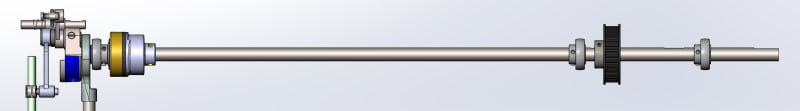

I recently had a problem with our machines shafts where the vibration increases after heat treating our shafts. The initial test was done with a 1040 steel shaft that was not heat treated for the first prototype and had a hardened chrome plating. The production sample Shaft was done with a 1040 steel shaft that was heat treated to 700HV and had a black oxide finish the shaft was designed to only be heat treated 500HV but I thought it wouldn't be a problem with having the material harder then specified but looks like it is but I still want to figure out what is going on. After measuring the shafts total runout they are both with in spec. The only part changed in the machines was the shafts all the same parts were used and when running the machines overall machine vibrations increased. All of my shaft design calculations I did show there will be no problem with the shaft deflecting in any significant amount considering the loads on the shaft are relatively small. With increasing the shaft hardness I assumed their would be little change in the vibration since heat treating has only a marginal affect on 1040 steel modulus of elasticity.
I am wondering if anyone can help me with this problem I have been debating three questions I think could cause this;
1. How the harmonic speed of a shaft will be affected in changing just the material hardness.
2. If the softer steel would have a higher dampening value even though the modulus of elasticity doesn't change much and could be absorbing some of the shock load.
3. If the hardened steel center of mass could be off slightly with having the shaft so hard (I don't think this is very likely or could be causing a significant problem).

The Vibration increases in both displacement and velocity when measuring it with an accelerometer in both horizontal and vertical directions. At 500 rpm's is where the displacement vibration is the worst with both shafts with the harder one vibrating more, but they run from 90 rpm's to 2000 rpm's the displacement of the entire machine is 1.0mm with the harder shaft and .7 with the softer one. When measuring the velocity with the harder shaft in the horizontal direction at 1800 rpm's the max vibration is about 120 mm/s where with the softer one it is 25 mm/s. The shaft is 12mm in diameter and is 639mm long. The shaft runs on 3 ball bearings with a load cantilevered out the front and a load from a belt between two bearings, see image below.

In the jpg you provided it is not clear to me what are bearings.
What is the large gray and gold component over at the left hand end of the shaft?
Are there two long keyways cut in the shaft over towards the right end ? Machining keyways like that often causes even stout shafts to bend.
Additionally, I'd not be surprised if the hardening process caused an un-keyed Ø12 mm shaft to bend and twist and reach for the sky.

In the JPG the arrows shown below point out the bearings.
The large gray and gold component over at the left hand end of the shaft is a counterbalance.
there are a couple of flat spots machined into the shaft for locating parts but all parts are attached with set screws/locating screws.

4 - Is there real estate available to "rigidly" support a 4th bearing around the middle of the shaft?
Normally more than two bearings supporting a shaft is asking ( begging) for trouble, but by inspection this long, thin shaft might not object and respond with large radial bearing loads due to imperfect colinearity.
5 - Was the (third) bearing at the extreme right, beyond the pulley, part of the original design, or added to stabilize things after some testing?
Time for some pictures/drawings of the entire machine/general arrangement.
