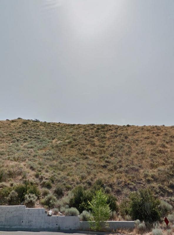

I am not sure if this is the correct forum to ask this question.
We are trying to figure out a solution for walking access of a steep slope (20-40 degrees, mostly 25 degrees). The plan is to be able to plant rows of shrubs along the contour of the land and watering them.
Initially, we intended to terracing the plot to make small parallel walkways along the contour of the slope for access. However, the rockery retaining walls would take up a lot of space and we may need riprap between them.
Another options would be wood boardwalks along the contour to provide access.
Is there any other solutions that we didn't think of?
Thanks!

This is what I got from the report:
The underlying material consists of Stodick very stony loam, 15 to 30 percent slopes (# 730). This
shallow, well-drained soil is on back slopes and side slopes of pediments. It formed in residuum and
alluvium derived dominantly from lacustrine sedimentary rocks.

We did think about Gabion basket.
The slope is very stable right now. We hope to minimize the excavation to prevent soil instability. We think the footprint of the gabion is too big and will cause more instability upstream.
One idea floating around is a timber wall with post/spike and back filled with gravel but there is concern about the stability of this type of construction:

This area is very arid, less than 7 inches per year. Raining is usually light and there is generally no thunderstorm.
There will be only walkways on this slope. No housing or any structure.
The shrubs will be planted directly into the slope.
Our concern about Rockery, crib wall, gabion that the footprint of the wall will be very big and involve lot of excavation ( 3-4 walls running along the contour to provide adequate access to most of the land) and will cause instability of the slope.

First of all, where is the timber wall going to be fixed? Within the CH, SM or the bedrock? The third case,and with a right dimensioning, may be regarded as a possible scenario. However, I wouldn't advice the wall to be constructed within the CH or SM soil at all.
There is shallow sandstone bedrock (14-20 inches deep)that the post will be fixed.
Can you give me more detail about the crib wall for walkway? So we excavate the area to the bed rock, put in the crib wall and the walkway is the top of the crib wall?
Well, given that it is very arid and that no structure will be constructed on the,and since that the slope's stability analysis shows that it is very stable, I think that a pile wall fixed within the bedrock will do the job.

I think the soldier pile timmber wall to create walkways would be the most economical way to achieve what we want.
So I guess we anchor the soldier pile directly onto the bedrock, put in the timber wall,then back fill the area with gravel. We would walk on top of the gravel area. Does that sound reasonable?
Do we need any excavation?
From a look at the concept image, I'm amazed that a structural solution is the first option for walkways between plantation shrubbery. Admittedly I am only considering slope stability, not aesthetics.
If your bedrock is within 20 inches of the surface, why not just cut the foot-paths in vertically to the narrowest acceptable width?
If the paths are kept to 2 or 3 feet wide, the cuttings made into the slope will be nominal. The geology doesn't sound problematic, but ultimately the stability would be most affected by the amount of water added through irrigation.
I've walked through hundreds of plantation roads/paths on steep slopes where thick soils are cut vertically- they often maintain themselves surprisingly well...of course there'll be the odd bit of maintenance but then again you've got hardly any soil on your site.
