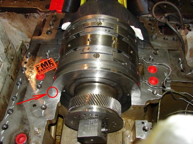

Photo is NOT smptrsn bearing.
I found this pic to show about chamfering the edge so it will fit into the radius of the housing.
these two halves of the shim are not a precision joint.
