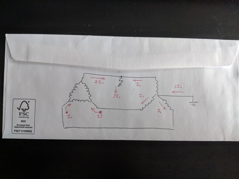

RE: Fault with delta (ungrounded) Source and Wye Grounded transformer
So I did say "If"... winky smile Isn't that when a "tired fuse" gives out? I agree it's going to happen under any normal circumstances.
Quote (waross)
That fuse will not blow. One of the unfaulted fuses will blow.
I suspect that the fuse on the faulted phase would act first, bearing in mind that the fuse is on the source side of the fault, not the transformer side of the fault. Below is my back-of-the-envelope (literally) sketch of the current flows in the 12.47 kV section, the fuses being located on the outgoing side of the tertiary delta (i.e., 2I0 current on the faulted phase vs only I0 on the two unfaulted phases).
I would also disagree with the placement of the "CL fuse" in the sequence diagram, which shows the current flowing through the fuse as I0, which is not correct (different currents will flow through the fuses on the faulted phase vs unfaulted phases) although I'm not sure how you would draw this as a sequence diagram. I'd probably work out the sequence currents without showing the fuses, and then calculate the individual phase currents based on these.
No I0 from a delta winding.
Perhaps the use of I0 to represent current was misleading--the ratios and direction of current were the key points. Below is the same circuit generated in ATP showing currents.
As an aside, this shows equal currents in each phase of the downstream transformer, so if this transformer had fuses (it doesn't in cuky2000's example) then in theory you couldn't predict which fuse would operate. In waross's real-world example, there is probably some load on the transformer secondary, which increases the current on the unfaulted phases and so one of these would operate first matching with what he has observed.
So, back to this. Just did a bit of modeling, grabbed the tertiary (13.2, not 12.47kV) of one of our auto banks and added in that station service transformer. In that case I get a fault current of 720A, 240A per phase from the 300kVA transformer; two phases (240A each) passing through the tertiary and coming back on the faulted phase (480A), all 720A to the fault.
What's your CLF? What does it do at 480A. It probably isn't current limiting at that point.
What's the "fuse curve" of your 300kVA transformer look like? 240A per phase is over 18 per unit on the transformer base. What about that 720A up the neutral-ground bond, what does that "fuse curve" look like?
If the CLF blows the fault remains, the current stops flowing as there is no path back out of the delta. The faulted phase will be at phase-phase voltage to ground between the tertiary winding and the open fuse and at zero volts to ground on the fault side of the open fuse. The other two phases would be at about phase-neutral voltage to ground.
Much better to have a delta high-side on that station service transformer and use some form of 59N to monitor for the first phase-ground fault.
